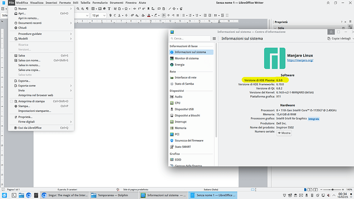

The upgrade to Plasma 6.3 broke the material-decoration with globally integrated menus. I have updated the decoration, please test it. Thank you!

The AUR package is not updated, please install manually.
Ps. Works on X11 only

This ONLY works with X11; maybe purge and rebuild.
Once it appears in Decorations, I can simply switch between Klassy and Material and the effect is instant.

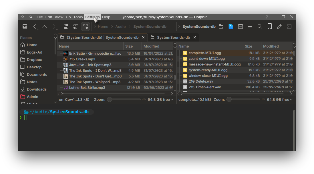

To be fair FF already does this and konsole/kate/dolphin all have decent interfaces with the menu hidden so it didnt really present much gain for where I would spend most of my time.
