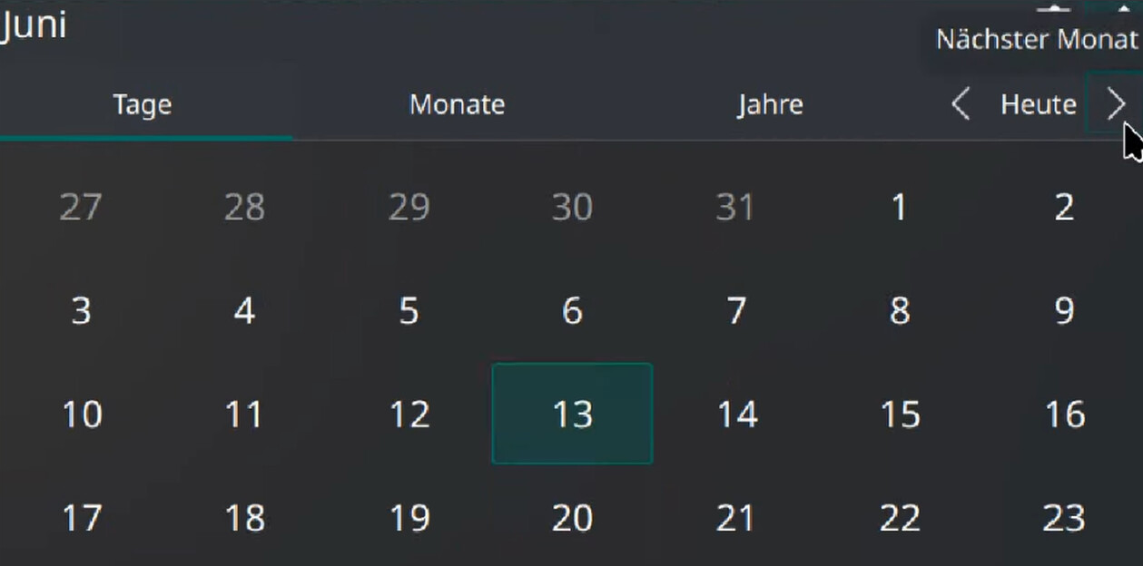

  2. As you can see on this screenshot it’s “June” and the button says “Next Month”

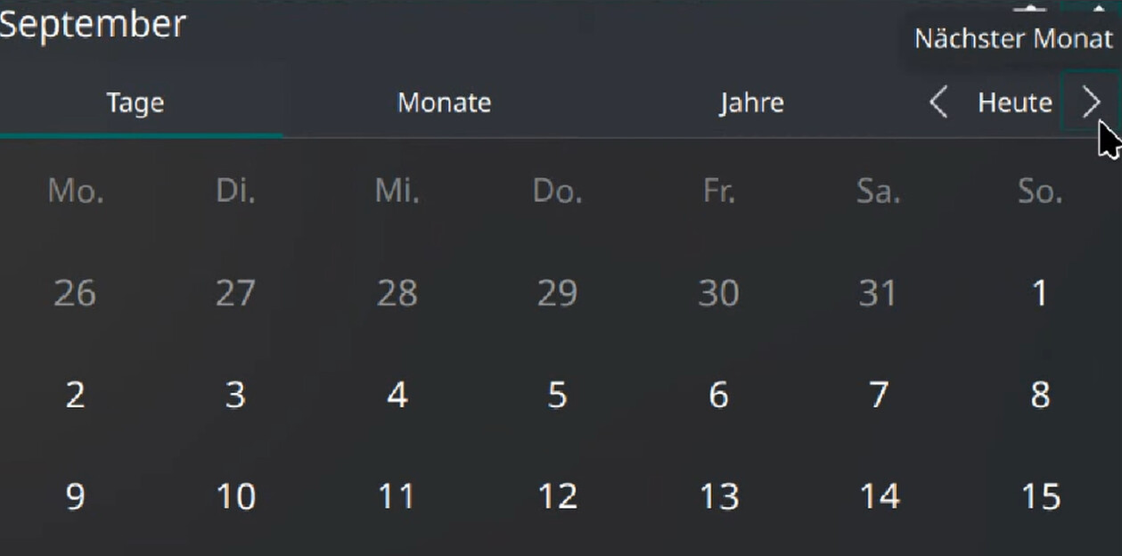

  3. After I press the button it switches to “September”, and that is obviously not the Month following June.
