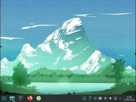

Buggy Zsh integration with Dolphin's embedded terminal
if Dolphin launches with the embedded terminal open it messes it up.
You may think the video is descriptive.
It’s not - not to me.
What do you expect vs what is happening?
Use words. :wink:
the Zsh graphics don’t load.
its terminal line start icon thing
gets replaced with ā€œvm-virtualbox%ā€.
