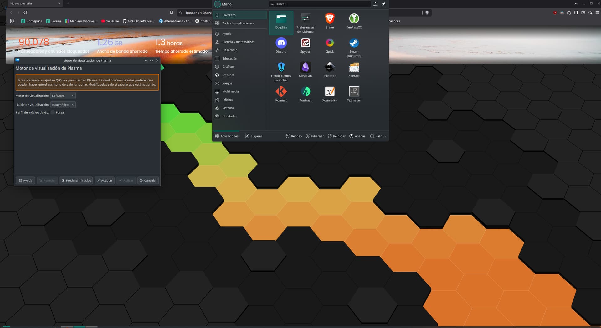

Hello, and sorry for such strange title but I don’t really know how to name this issue.
Just after the update I rebooted as always and I saw that the GRUB was in some “low resolution mode” (similar to when you play really old games that don’t even allow 1080p but will occupy the whole screen anyway), something I found strange since it hand’t happened before.
After that, when I log in (X11), I had the issue I am showing in the next image.
Summary
In the image you can see 3 “windows”, first one belonging to Brave Browser, second is Plasma Engine and third is the Plasma Menu (the one that appears when you click on the plasma icon on bottom left corner).
The image seems ok since there is no graphical issue at all. The problem are the next points:
  • Windows always appear on top, just where Brave Browser appears, and it happens with all the applicantions, though width is application dependant.
  • I can’t move the windows below the point where you see the Plasma engine window.
    • I can change their width and height beyond that point though.
  • The plasma menu appears where you see it and sometimes with some visual bug (the shutdown, hibernate, … buttons appear dupped and laggy)

About logs, I don’t know what should I send, and sending everything would be a mess since I have some UFW Block every 5 seconds, so the logs are full and hard to read without proper filtering.
Also I have this icon that didn’t appear before. It is about the Plasma Engine.
Summary
Error_2
The second, right next to packages manager icon.
This could very well be configuration files with invalid data. This may happen when widgets gets out sync with plasma releases.
Not all widgets are fully maintained or updated in timely manner to match plasma releases.
Plasma engine - although I have used plasma for several years I have never seen a configuration item for it. Yes there is a binary plasmaengineexplorer but I have no idea what can be done - but since you have a warning - I believe something trigger the warning.

I suggest you create a new user - then test if the issue persist - if it fixes the issue - use the plasma reset script
I suspect it’s a translation error. :wink:
I created the user but the problem persist there.
According to deepl it is “plasma display engine”, I thought that with the image I could skip the word “display”.
Sorry if it was confusing.
I am still at loss what you mean
There is a section Display & Monitor in System Settings but there is also a Window Management section.
What grub does at boot regarding font size and display - simply ignore - it has no meaning to when Plasma takes over.
Many people think that images is better than words but that is not true - you know what the image means - those seeing the image have no clue - which is why it is so important to take the time to describe the issue properly.

In Plasma, there is the window manager, which is kwin, and there is the display server, which is either Wayland or X11.

When I open any app, the window of such app always appears at the top of the screen.
If I try to move the window to the center of the screen, it gets blocked at around 1/5 of the screen (from top). The start menu also appears there, when it should be at the bottom left corner, just like the first image.

Ok I found it. It is “plasma renderer” in english.
I have searched my system - and I cannot find anything in System Settings that looks like the one you are referring to.

I suggest you reset your plasma to the default Breeze or Breath theme - then use the reset script to clear your configurations - for best result - log off - switch to a TTY and run the script.
Look at these files/folders - they are save to remove
  • ~/.local/share/kscreen
  • ~/.config/kwinrc
  • ~/.conf/kwinoutputconfig.json

It is not in system settings, I only find it through search in the start menu.
I found this link with an image where it should be (need to scroll one or two times to see it), it is the first image, and that is what I am referring to.
The post is really old, so KDE must have moved it somewhere else.

I found one - Plasma Renderer - on english language systems, which resembles what you showed.
It should be set to Automatic for both dropdowns and Force unchecked.

I run the script and deleted the files you mentioned but the problem persist.
The first option of plasma renderer switched itself to Software again.

I think the problem was related to the second monitor. I turned it on and saw that it was stuck in the manjaro loading screen, right after login.
I don’t know why this happened, or what cause the issue. But I solved it by rebooting without my second monitor (HDMI) plugged in.
The steps taken to solve the issue:
  1. Did the reset (idk if it was necessary):
  1. Reinstalled kwin (everything was black on my main monitor after this).
  2. Reboot without my second monitor plugged in.
  3. Now everything works fine. Both X11 and Wayland.
  4. I reboot with second monitor plugged in and the main monitor set as primary (it resetted after the first step).
  5. The issue happens again.
Since I have to configure everything again I will stay in wayland now, so I can configure HDR.
I won’t mark this as solved yet since I want to see if a more expert opinion knows something about this.

Yes, it still happens. I need to boot without my second monitor plugged.
Well, I don’t think this is exactly a solution but, I simply reinstalled manjaro and configured everything back again. I have no issues now.
Extra details
Just to add more “information” to this topic. With one screen only, I could move the windows to the right side of the screen and when they reached the limit, they appeared on the left side of the screen. As if it were some cyclic screen, but only in that direction. Though the mouse wasn’t cyclic.
In other words, I could move windows from left to right infinitely without losing the window cause it appeared on the left side.
I couldn’t do it the other way around, and the right side is where the second monitor is configured.
