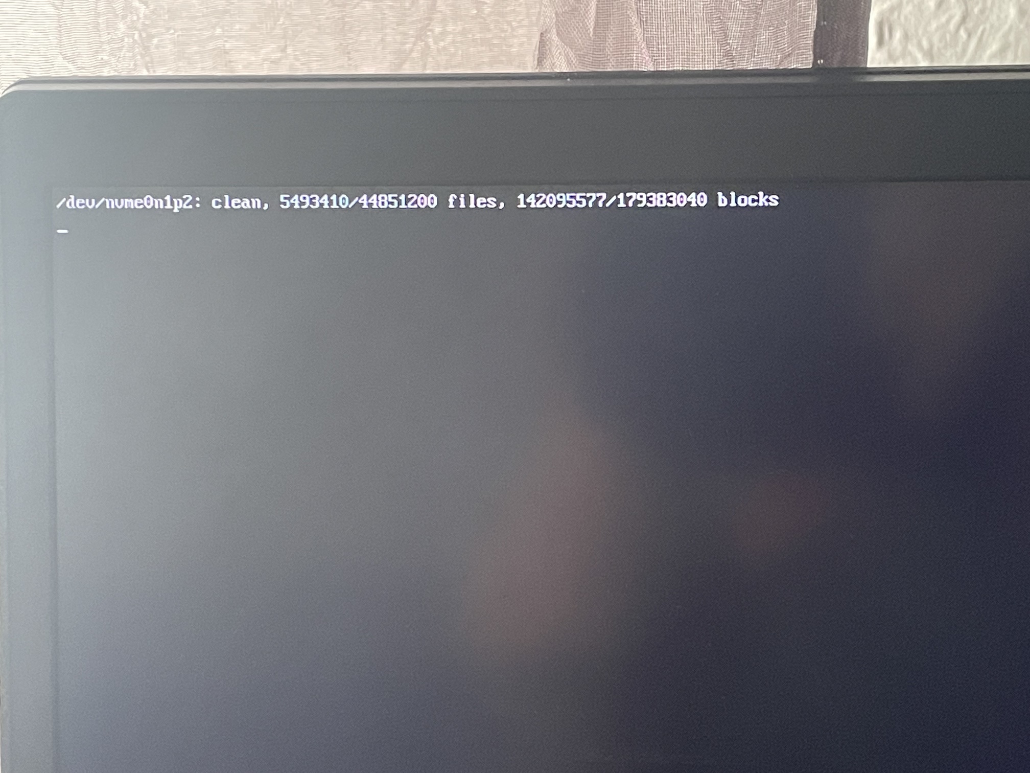

I have just updated my system and am stuck in a black screen only showing me the following when trying to boot into manjaro
How can I proceed? I can log into tty2 but wouldn’t know what to do from here (I am using Plasma as my DE)

Now i am in the black screen again (The same issue as before). So I suppose this driver caused the issue.
