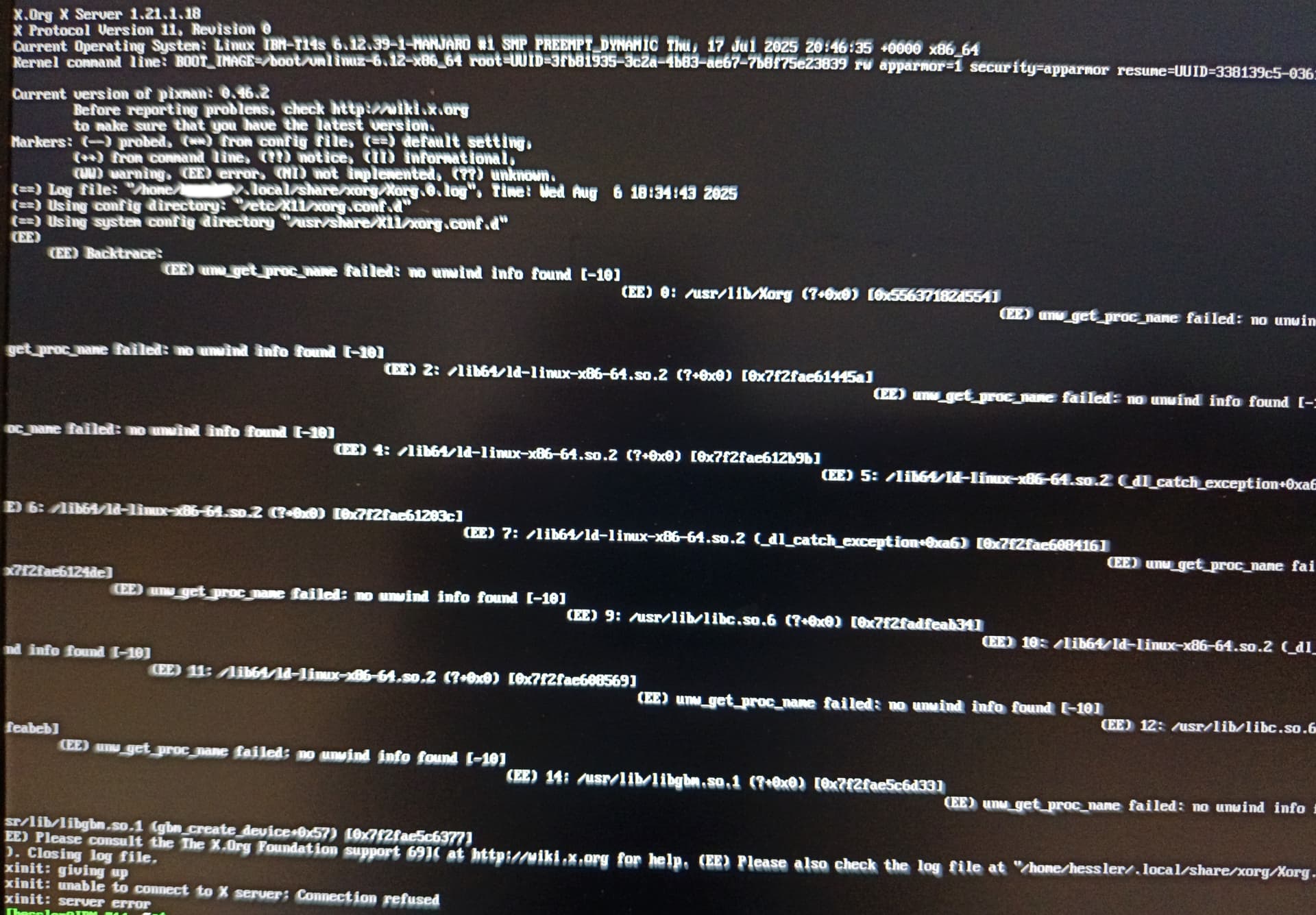

Reboot and in virtual konsole: LogIn with myname and
systemctl stop sddm.service
startx
Sorry for the screenshot, could not get it into a txt.file.
Furthermore, I notice that before first boot message Process Core Dump (PID xxxx there is the entry `Started Manage, Install and generate Color Profiles. Could this be a hint?
Second step:
Done! Last boot message is now Reached target Graphical interface., e.g. TLP-messages are gone.

Since xorg keeps crashing and the error looks the same as before,
I’d reinstall xorg - all of it.
sudo pacman -Syu xorg
The error message mentions a log file at ~/.local/share/xorg/Xorg.0.log
Look at it.
Since you previously deleted the pacman cache, new packages will be downloaded and used.
Perhaps a miracle happens and it starts working then.
Or you sift through the pacman log - what got updated before it all fell apart …
/var/log/pacman.log

Done, all (51) packages, same issue
Here is the LOG-file, I don’t understand really much:

[   278.221] (II) modesetting: Driver for Modesetting Kernel Drivers: kms
[   278.223] (WW) Falling back to old probe method for modesetting
[   278.223] (EE) open /dev/dri/card0: No such file or directory
[   278.223] (WW) VGA arbiter: cannot open kernel arbiter, no multi-card support
[   278.223] (II) AMDGPU(0): Creating default Display subsection in Screen section
	"Default Screen Section" for depth/fbbpp 24/32
[   278.224] (==) AMDGPU(0): Depth 24, (--) framebuffer bpp 32
[   278.224] (II) AMDGPU(0): Pixel depth = 24 bits stored in 4 bytes (32 bpp pixmaps)
[   278.224] (==) AMDGPU(0): Default visual is TrueColor
[   278.224] (II) Applying OutputClass "AMDgpu" options to /dev/dri/card1
[   278.224] (==) AMDGPU(0): RGB weight 888
[   278.224] (II) AMDGPU(0): Using 8 bits per RGB (8 bit DAC)
[   278.224] (--) AMDGPU(0): Chipset: "AMD Radeon Graphics" (ChipID = 0x1636)
[   278.224] (II) Loading sub module "fb"
[   278.224] (II) LoadModule: "fb"
[   278.224] (II) Module "fb" already built-in
[   278.224] (II) Loading sub module "dri2"
[   278.224] (II) LoadModule: "dri2"
[   278.224] (II) Module "dri2" already built-in
[   278.230] (EE)
[   278.230] (EE) Backtrace:
[   278.231] (EE) unw_get_proc_name failed: no unwind info found [-10]
[   278.231] (EE) 0: /usr/lib/Xorg (?+0x0) [0x55637182d554]
[   278.231] (EE) 1: /usr/lib/libc.so.6 (?+0x0) [0x7f2fadf96ef0]
[   278.232] (EE) unw_get_proc_name failed: no unwind info found [-10]
[   278.232] (EE) 2: /lib64/ld-linux-x86-64.so.2 (?+0x0) [0x7f2fae61445a]
[   278.233] (EE) unw_get_proc_name failed: no unwind info found [-10]
[   278.233] (EE) 3: /lib64/ld-linux-x86-64.so.2 (?+0x0) [0x7f2fae616931]
[   278.234] (EE) unw_get_proc_name failed: no unwind info found [-10]
[   278.234] (EE) 4: /lib64/ld-linux-x86-64.so.2 (?+0x0) [0x7f2fae612b9b]
[   278.234] (EE) 5: /lib64/ld-linux-x86-64.so.2 (_dl_catch_exception+0xa6) [0x7f2fae608416]
[   278.235] (EE) unw_get_proc_name failed: no unwind info found [-10]
[   278.235] (EE) 6: /lib64/ld-linux-x86-64.so.2 (?+0x0) [0x7f2fae61203c]
[   278.236] (EE) 7: /lib64/ld-linux-x86-64.so.2 (_dl_catch_exception+0xa6) [0x7f2fae608416]
[   278.237] (EE) unw_get_proc_name failed: no unwind info found [-10]
[   278.237] (EE) 8: /lib64/ld-linux-x86-64.so.2 (?+0x0) [0x7f2fae6124de]
[   278.237] (EE) 9: /usr/lib/libc.so.6 (?+0x0) [0x7f2fadfeab34]
[   278.238] (EE) 10: /lib64/ld-linux-x86-64.so.2 (_dl_catch_exception+0xa6) [0x7f2fae608416]
[   278.239] (EE) unw_get_proc_name failed: no unwind info found [-10]
[   278.239] (EE) 11: /lib64/ld-linux-x86-64.so.2 (?+0x0) [0x7f2fae608569]
[   278.239] (EE) 12: /usr/lib/libc.so.6 (?+0x0) [0x7f2fadfea623]
[   278.240] (EE) 13: /usr/lib/libc.so.6 (dlopen+0x6b) [0x7f2fadfeabeb]
[   278.241] (EE) unw_get_proc_name failed: no unwind info found [-10]
[   278.241] (EE) 14: /usr/lib/libgbm.so.1 (?+0x0) [0x7f2fae5c6d33]
[   278.242] (EE) 15: /usr/lib/libgbm.so.1 (?+0x0) [0x7f2fae5c6176]
[   278.242] (EE) 16: /usr/lib/libgbm.so.1 (gbm_create_device+0x57) [0x7f2fae5c6377]
[   278.243] (EE) unw_get_proc_name failed: no unwind info found [-10]
[   278.243] (EE) 17: /usr/lib/xorg/modules/drivers/amdgpu_drv.so (?+0x0) [0x7f2fad7bd368]
[   278.243] (EE) 18: /usr/lib/Xorg (InitOutput+0x16b1) [0x5563718533f1]
[   278.243] (EE) 19: /usr/lib/Xorg (?+0x0) [0x5563716ff6e5]
[   278.244] (EE) unw_get_proc_name failed: no unwind info found [-10]
[   278.244] (EE) 20: /usr/lib/libc.so.6 (?+0x0) [0x7f2fadf806b5]
[   278.244] (EE) 21: /usr/lib/libc.so.6 (__libc_start_main+0x89) [0x7f2fadf80769]
[   278.245] (EE) 22: /usr/lib/Xorg (_start+0x25) [0x556371700d15]
[   278.245] (EE)
[   278.245] (EE) Segmentation fault at address 0x8
[   278.245] (EE)
Fatal server error:
[   278.245] (EE) Caught signal 11 (Segmentation fault). Server aborting
[   278.245] (EE)
[   278.245] (EE)
Please consult the The X.Org Foundation support
	 at http://wiki.x.org
 for help.
This is the LOG-file just before the issue occured:
[2025-07-21T10:04:46+0200] [ALPM] transaction started
[2025-07-21T10:04:46+0200] [ALPM] removed libtar (1.2.20-7)
[2025-07-21T10:04:46+0200] [ALPM] removed quazip-qt5 (1.5-1)
[2025-07-21T10:04:47+0200] [ALPM] removed lib32-pipewire (1:1.4.6-1)
[2025-07-21T10:04:47+0200] [ALPM] removed lib32-libpipewire (1:1.4.6-1)
[2025-07-21T10:04:47+0200] [ALPM] transaction completed
[2025-07-21T10:04:47+0200] [ALPM] running '30-systemd-update.hook'...
[2025-07-21T10:04:52+0200] [PAMAC] synchronizing package lists
[2025-07-21T10:10:40+0200] [PAMAC] synchronizing package lists
[2025-07-21T10:11:40+0200] [PACMAN] Running 'pacman -Syuu'
[2025-07-21T10:11:40+0200] [PACMAN] synchronizing package lists
[2025-07-21T10:11:41+0200] [PACMAN] starting full system upgrade
[2025-07-21T10:15:12+0200] [PAMAC] synchronizing package lists
[2025-07-21T10:20:46+0200] [ALPM] running '60-mkinitcpio-remove.hook'...
[2025-07-21T10:20:48+0200] [ALPM] running 'ghc-unregister.hook'...
[2025-07-21T10:21:03+0200] [ALPM] running 'kernel-alive-pre.hook'...
[2025-07-21T10:21:05+0200] [ALPM] running 'thunderbird-pre.hook'...
[2025-07-21T10:21:05+0200] [ALPM] transaction started
[2025-07-21T10:21:05+0200] [ALPM] upgraded libldap (2.6.10-1 -> 2.6.10-2)
[2025-07-21T10:21:05+0200] [ALPM] upgraded sqlite (3.50.2-1 -> 3.50.3-1)
[2025-07-21T10:21:06+0200] [ALPM] upgraded apparmor (4.1.1-1 -> 4.1.1-3)
[2025-07-21T10:21:06+0200] [ALPM] upgraded libxml2 (2.14.4-2 -> 2.14.5-1)
[2025-07-21T10:21:07+0200] [ALPM] upgraded llvm-libs (20.1.7-1 -> 20.1.8-1)
[2025-07-21T10:21:07+0200] [ALPM] upgraded compiler-rt (20.1.7-1 -> 20.1.8-1)
[2025-07-21T10:21:07+0200] [ALPM] upgraded curl (8.14.1-1 -> 8.15.0-1)
[2025-07-21T10:21:09+0200] [ALPM] upgraded clang (20.1.7-1 -> 20.1.8-1)
[2025-07-21T10:21:09+0200] [ALPM] upgraded cpupower (6.15-1 -> 6.15-2)
[2025-07-21T10:21:09+0200] [ALPM] error: could not extract /usr/lib/libSPIRV-Tools.so (Truncated tar archive detected while reading data)
[2025-07-21T10:21:09+0200] [ALPM] error: problem occurred while upgrading spirv-tools
[2025-07-21T10:21:09+0200] [ALPM] upgraded spirv-tools (1:1.4.313.0-1 -> 1:1.4.321.0-1)
[2025-07-21T10:21:09+0200] [ALPM] transaction failed
[2025-07-21T10:22:55+0200] [PAMAC] synchronizing package lists
[2025-07-21T10:23:40+0200] [ALPM] running '60-mkinitcpio-remove.hook'...
[2025-07-21T10:23:40+0200] [ALPM] running 'ghc-unregister.hook'...
[2025-07-21T10:23:48+0200] [ALPM] running 'kernel-alive-pre.hook'...
[2025-07-21T10:23:48+0200] [ALPM] running 'thunderbird-pre.hook'...
[2025-07-21T10:23:49+0200] [ALPM] transaction started
[2025-07-21T10:23:49+0200] [ALPM] upgraded glslang (1:1.4.313.0-1 -> 1:1.4.321.0-1)
[2025-07-21T10:23:49+0200] [ALPM] upgraded vulkan-icd-loader (1.4.313.0-1 -> 1.4.321.0-1)
[2025-07-21T10:23:49+0200] [ALPM] upgraded shaderc (2025.2-2 -> 2025.3-1)
[2025-07-21T10:23:49+0200] [ALPM] upgraded libplacebo (7.351.0-1 -> 7.351.0-2)
[2025-07-21T10:23:49+0200] [ALPM] upgraded x264 (3:0.164.r3108.31e19f9-2 -> 3:0.164.r3108.31e19f9-3)
[2025-07-21T10:23:49+0200] [ALPM] upgraded mesa (1:25.1.5-1 -> 1:25.1.6-1)
[2025-07-21T10:23:49+0200] [ALPM] upgraded ffmpeg (2:7.1.1-4 -> 2:7.1.1-5)
[2025-07-21T10:23:49+0200] [ALPM] upgraded libfilezilla (1:0.50.0-1 -> 1:0.51.0-1)
[2025-07-21T10:23:50+0200] [ALPM] upgraded gstreamer (1.26.3-2 -> 1.26.4-1)
[2025-07-21T10:23:50+0200] [ALPM] upgraded gst-plugins-base-libs (1.26.3-2 -> 1.26.4-1)
[2025-07-21T10:23:50+0200] [ALPM] upgraded gst-plugins-bad-libs (1.26.3-2 -> 1.26.4-1)
[2025-07-21T10:23:50+0200] [ALPM] upgraded filezilla (3.69.1-1 -> 3.69.2-1)
[2025-07-21T10:23:51+0200] [ALPM] upgraded gdal (3.11.1-2 -> 3.11.3-1)

There were two errors
and warnings, one may be related to the screen issue:
[ALPM-SCRIPTLET] ==> WARNING: consolefont: no font found in configuration

xorg keeps crashing for no apparent reason
If I was using Manjaro, I’d have timeshift snapshots to roll back such a problematic update.
You’d probably have done that by now if you had timeshift snapshots (or a recent backup).
I have no idea how to proceed to find the cause of the constant crashing of xorg.
