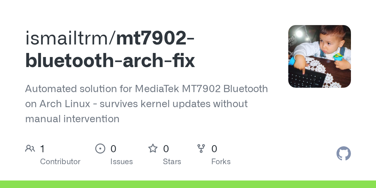

Try using this for Bluetooth:
I cannot confirm if this works but it has very good documentation

It’s an issue with MediaTek being slow in supporting Linux.
The workaround @nikgnomic suggests is the result of some very smart people reverse-engineering the Windows driver. Their fix, while completely unofficial, is open-source and works so well it has been added to Linux 7.1 as a permanent feature.
So you have three choices:
  1. Use the workaround above,
  2. Install the Linux 7.1 release candidate (sudo pacman -Syu linux71) if you’re on either Testing or Unstable branches. I’m running it on both, but I have an older MediaTek chip that does not have the problem.
  3. Wait a few weeks for Linux 7.1 to be formally released.
