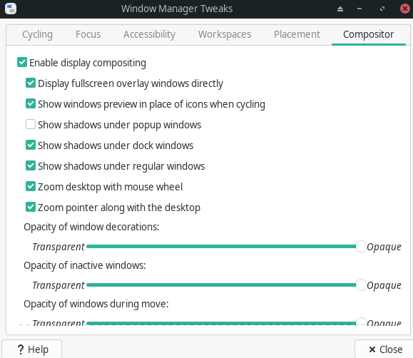

Oh. One more thought. Do you have the compositor running? If not, please try starting it.
Hi again, so it’s the same thing with kernel 6.6.
This is the xfce compositor:
