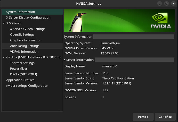

Hello Linux Masters,
I’m trying to use the Manjaro with Windows on dual boot (I removed fast boot and Windows hibernation so don’t worry about that).
Problem:
After waking up from a sleep there is a high chance that the screen will be totally black and the only thing I can do is a hard reset… Keyboard and mouse turns on and there is a signal to the monitor.
Sometimes it works, I don’t know why, and then I can see the lock screen.
I tried entering my credentials with a black screen, but nothing happens.

  Device-1: NVIDIA GA102 [GeForce RTX 3080 Ti] vendor: Micro-Star MSI
    driver: nvidia v: 545.29.06 alternate: nouveau,nvidia_drm non-free: 545.xx+
    status: current (as of 2024-02; EOL~2026-12-xx) arch: Ampere code: GAxxx
    process: TSMC n7 (7nm) built: 2020-2023 pcie: gen: 4 speed: 16 GT/s
    lanes: 16 bus-ID: 06:00.0 chip-ID: 10de:2208 class-ID: 0300

  Display: x11 server: X.org v: 1.21.1.11 with: Xwayland v: 23.2.4
    compositor: gnome-shell driver: X: loaded: nvidia gpu: nvidia display-ID: :0
    screens: 1
  Screen-1: 0 s-res: 3840x2160 s-size: <missing: xdpyinfo>
  Monitor-1: Unknown-1 mapped: DP-2 res: 3840x2160 dpi: 155
    size: 630x360mm (24.8x14.17") modes: 1024x768

I uninstalled Nvidia drivers:
sudo mhwd -r pci video-nvidia
And installed them again:
sudo mhwd -a pci nonfree 0300
And rebooted.
I tried suspending many times and there’s no black screen. Also my mouse and keyboard immediately respond to my actions and there is no random login screen.
Thankfully…
