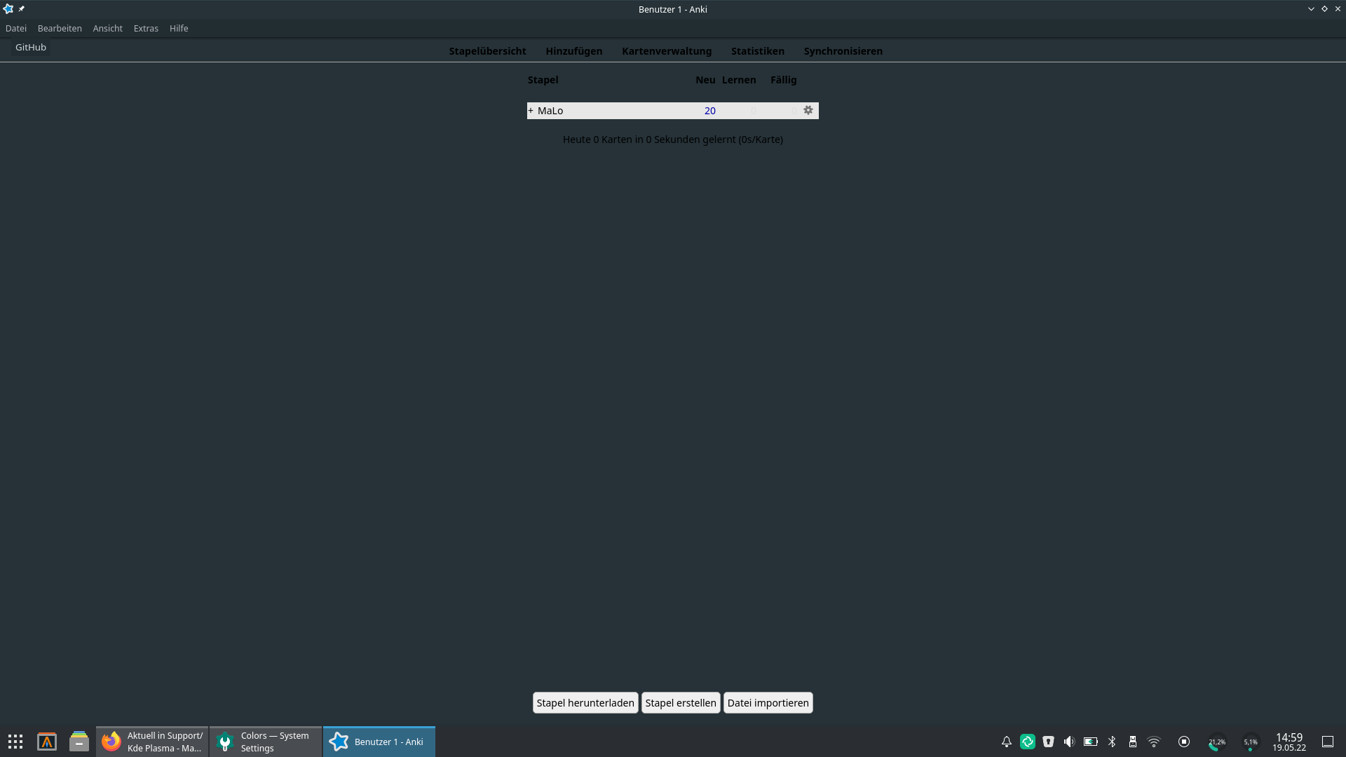

At some application the font is black and ignore the theme setting. Even I have sent the color to white.
Anki:
matplotlib:

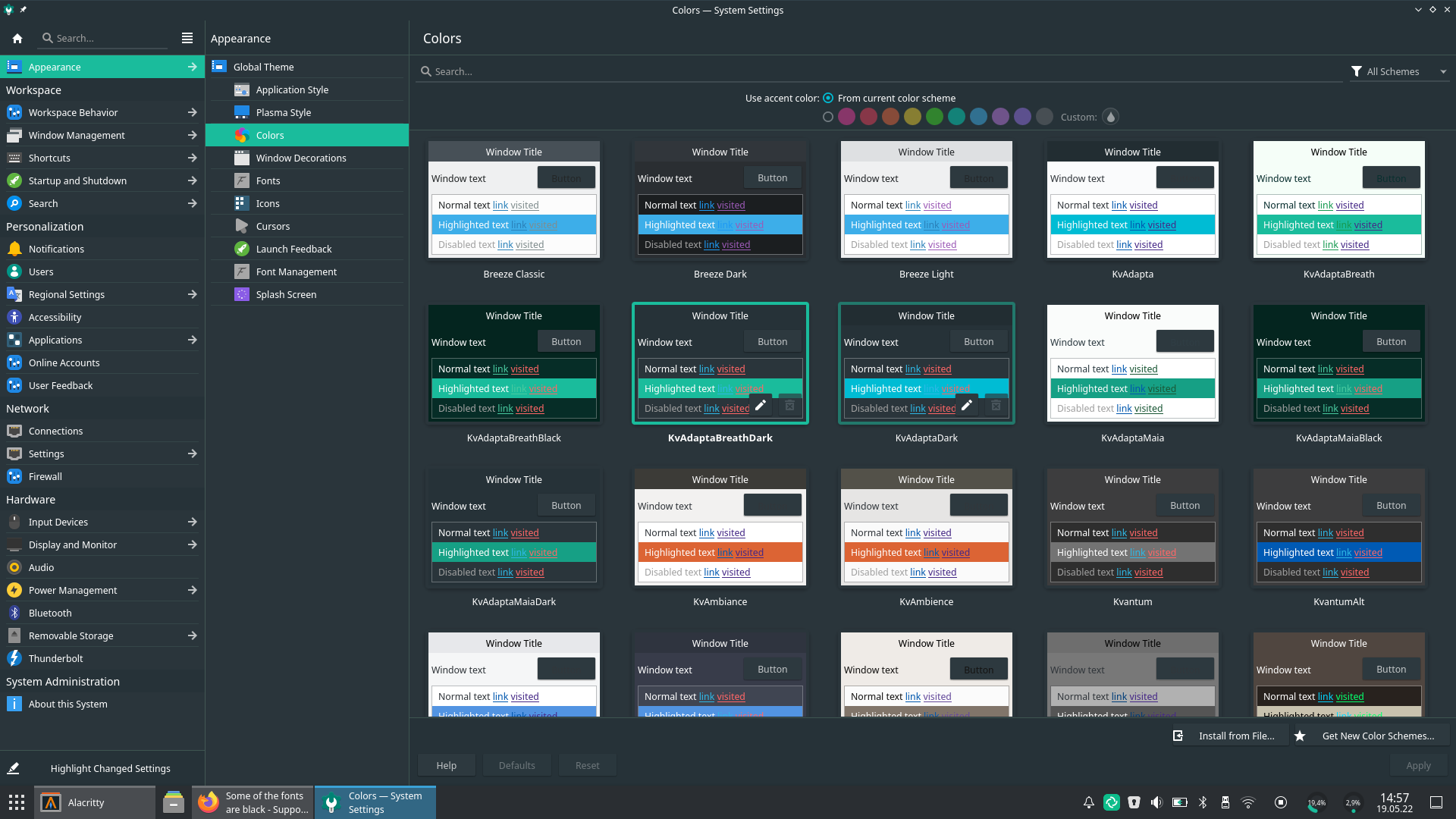

But in a huge number of programs the font is white.
It looks like the programs ignore the “Colors” section and follow only the “Application Style”.

Regarding Anki, I just installed it and can confirm the dark font on dark background.
However, change in Anki Menu > Tools > Preferences > Basic > Theme: Dark and it has a dark theme. It runs on Qt6 so the looks is slightly different, well because of Qt6.

Yes it doesn’t affect the look of Anki, only the application preference change does.
