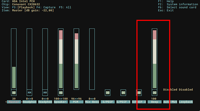

I tested it myself:
  1. I unmute beep in alsamixer and keep sure, that the module pcspkr is loaded.
lsmod | grep pcspkr
  1. I switched to another TTY. For example CTRL + ALT + F3. There it works, and that is intended in a non-graphical environment.
  2. In a Terminal-Emulator, it needs to enabled and is rather optional and depends highly on the ability of the terminal.
  3. I would suggest that you use beep. The linked wiki article explains what to do. Then you can play tetris sound track in your pc-speaker:

I keyed in ‘alsamixer’.
I get:
speaker
There appears to be no Beep column.
Select the sound card: F6
Yes, I selected the Default:0 HDA Intel MID and there it was, similar to yours with multiple columns including the Beep. I also set that to 100.
But how do I make it stick. The next time I try ‘alsamixer’ I receive the original single column and with F6 also the previously selected Default: 0 is not the one selected.
Sorry, no idea :man_shrugging: When I set it and type ESC and run it again, it stays the same. So it is saved.
Yes, if I select the Default: 0 again, the setting I made are saved.
Just the F6 selection does not stick.

I would suggest posting response to amixer --card=0 to show ALSA controls
There may or may not be a mixer control for setting ‘Beep’ level on the audio codec
