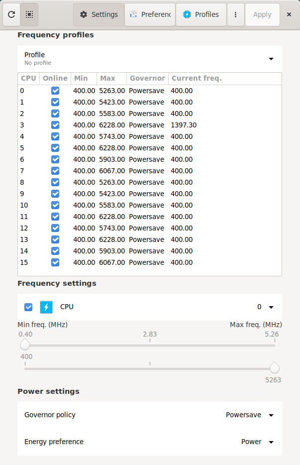

Even CPUPower-gui showing higher CPU usage compared to idle.
idle
