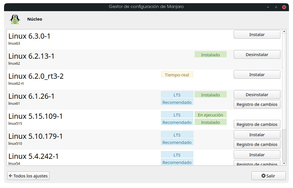

I uninstalled 6.3.0-1 which is more recent and installed 5.15.109-1, right now running on the system but no change unfortunately… This is really maddening.
I’ve been wondering from some previously read threads if grub configuration could cause something similar.
