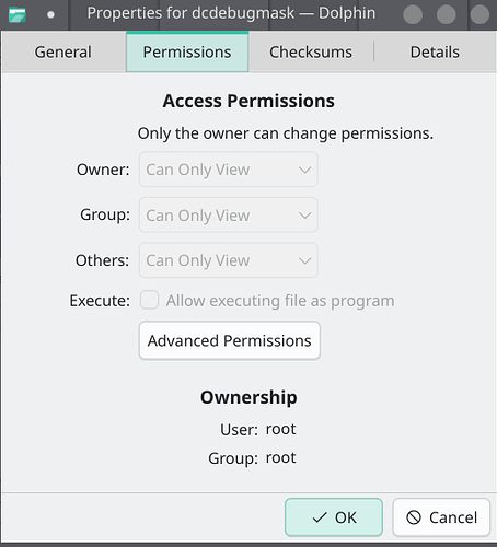

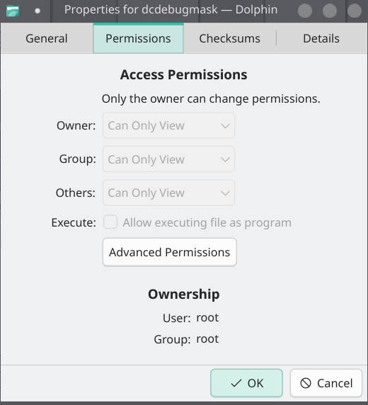

The file dcdebugmask has read-only permission, even for the root user.
Since this event occurs very rarely, I will make a note of this suggested solution and leave the system unchanged.
Thanks for your info!
Some packagers do that because they don’t understand UNIX. :grin:
The root account has write access to everything, regardless of its permissions, as long as the filesystem itself is mounted writable. :wink:

 sudo sh -c 'echo 0x200 > /sys/module/amdgpu/parameters/dcdebugmask'                         ✔
[sudo] password for gloewa:
sh: line 1: /sys/module/amdgpu/parameters/dcdebugmask: Permission denied
