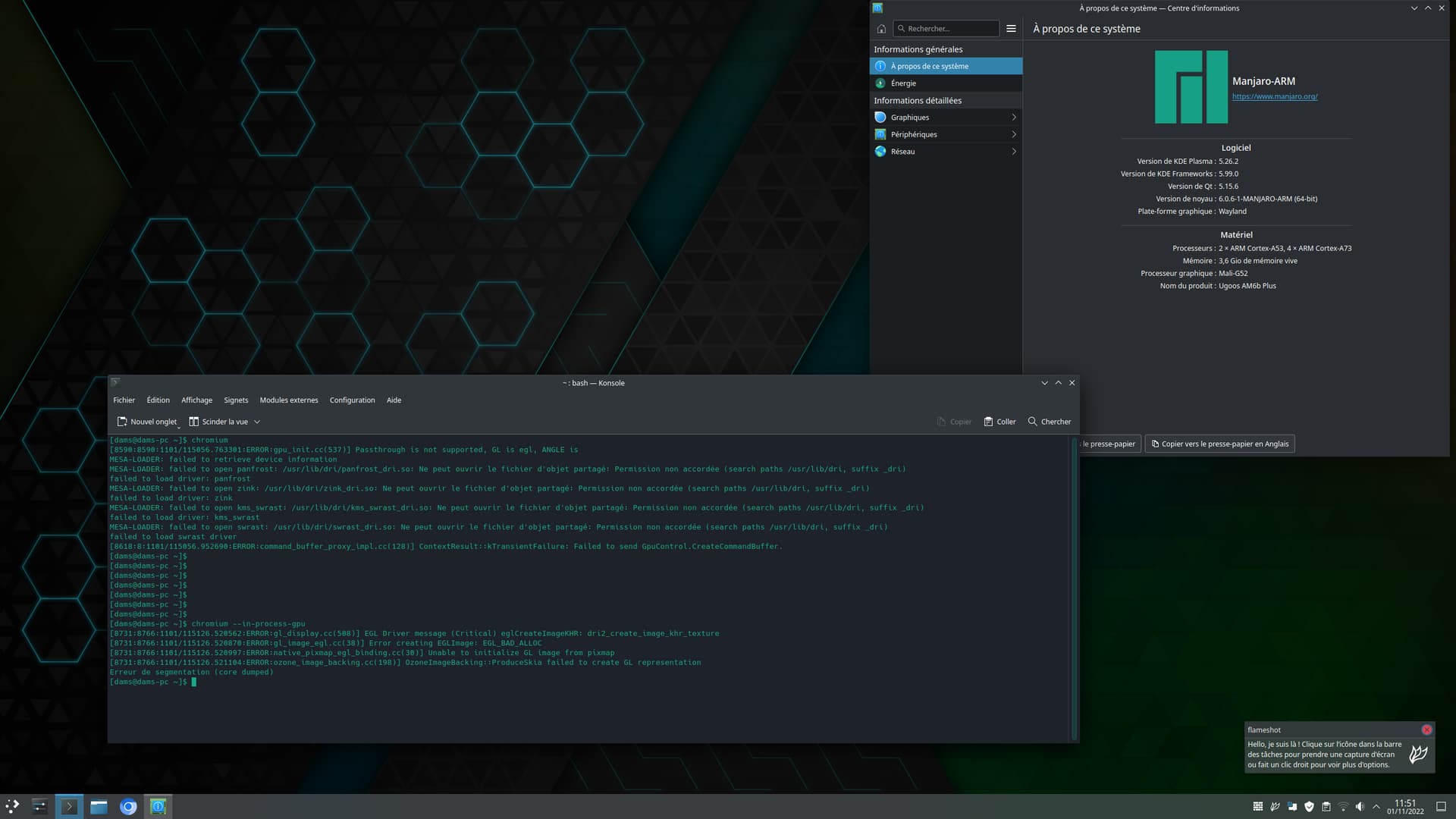

How to get Waydroid working
If you follow these steps, you should have Waydroid working fine.
Remember, Waydroid only works on wayland!
  • Install waydroid-image and all it’s dependencies.
  • Run pkexec setup-waydroid.
  • You should now be able to launch Waydroid. The first launch takes a while.

Hello, chromium refuses to start if the --in-process-gpu flag is enabled since mesa 22.2.0.
is there a way to revert to mesa 22.1.7 please?
Any output when the command is run in the terminal?
In any case, it seems to have been reported (by you) to Mesa and they have also already fixed it with this commit.
So can you try installing mesa-git from Unstable branch to see if that fixes it for you?
If that doesn’t work, another thing you can try is switching to the X11 session in the login screen, that way we can see if it’s a Wayland issue (the log said something about ozone).
Hello,
I tested with mesa-git 22.3.0 from 30/10/2022 and it’s the same result
so on wayland:
with --in-process-gpu chromium refuse to start
on X11
chromium starts with --in-process-gpu but I tested WebGL Aquarium and it’s terribly slow ~22fps with 500 fish
So it does work on X11, just slow?
I’ll keep an eye on the bug report, to see if the mesa devs have more solutions.
Yes it work but i have better performance on wayland without --in-process-gpu enabled
thank, I’m going to flesh out my mesa gitlab bug report a bit
Hi @Strit and @Dams2000,
I am have the same issue in Chromium as @Dams2000 is facing on both Manjaro-Arm-Gnome and Manjaro-Arm-KDE.
With mesa-22.1.7-1 for example starting Chromium with:
chromium --incognito --ozone-platform-hint=auto --in-process-gpu
or
chromium --incognito --ozone-platform-hint=auto --no-sandbox --test-type
Used to work with Wayland option and GPU Acceleration.
But now with mesa 22.2.1-1, Chromium will start and return a “Segmentation fault (core dumped)”
[jfl@jfl-mnjro ~]$ chromium --incognito --in-process-gpu --ozone-platform-hint=auto
[1097:1131:1102/013346.353832:ERROR:gl_display.cc(508)] EGL Driver message (Critical) eg
lCreateImageKHR: dri2_create_image_khr_texture
[1097:1131:1102/013346.354212:ERROR:gl_image_egl.cc(38)] Error creating EGLImage: EGL_BA
D_ALLOC
[1097:1131:1102/013346.354407:ERROR:native_pixmap_egl_binding.cc(30)] Unable to initiali
ze GL image from pixmap
[1097:1131:1102/013346.354716:ERROR:ozone_image_backing.cc(198)] OzoneImageBacking::Prod
uceSkia failed to create GL representation
[1102/013346.374718:ERROR:elf_dynamic_array_reader.h(64)] tag not found
[1102/013346.394294:ERROR:process_memory_linux.cc(49)] pread64: Input/output error (5)
[1137:1144:1102/013357.445824:ERROR:broker_posix.cc(40)] Recvmsg error: Connection reset
by peer (104)
[jfl@jfl-mnjro ~]$
