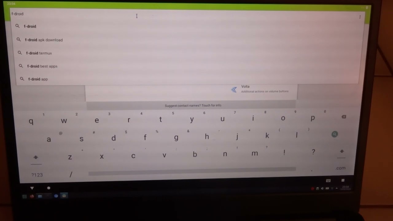

with mainline kernel, waydroid start but with a black screen then a completely buggy display .
