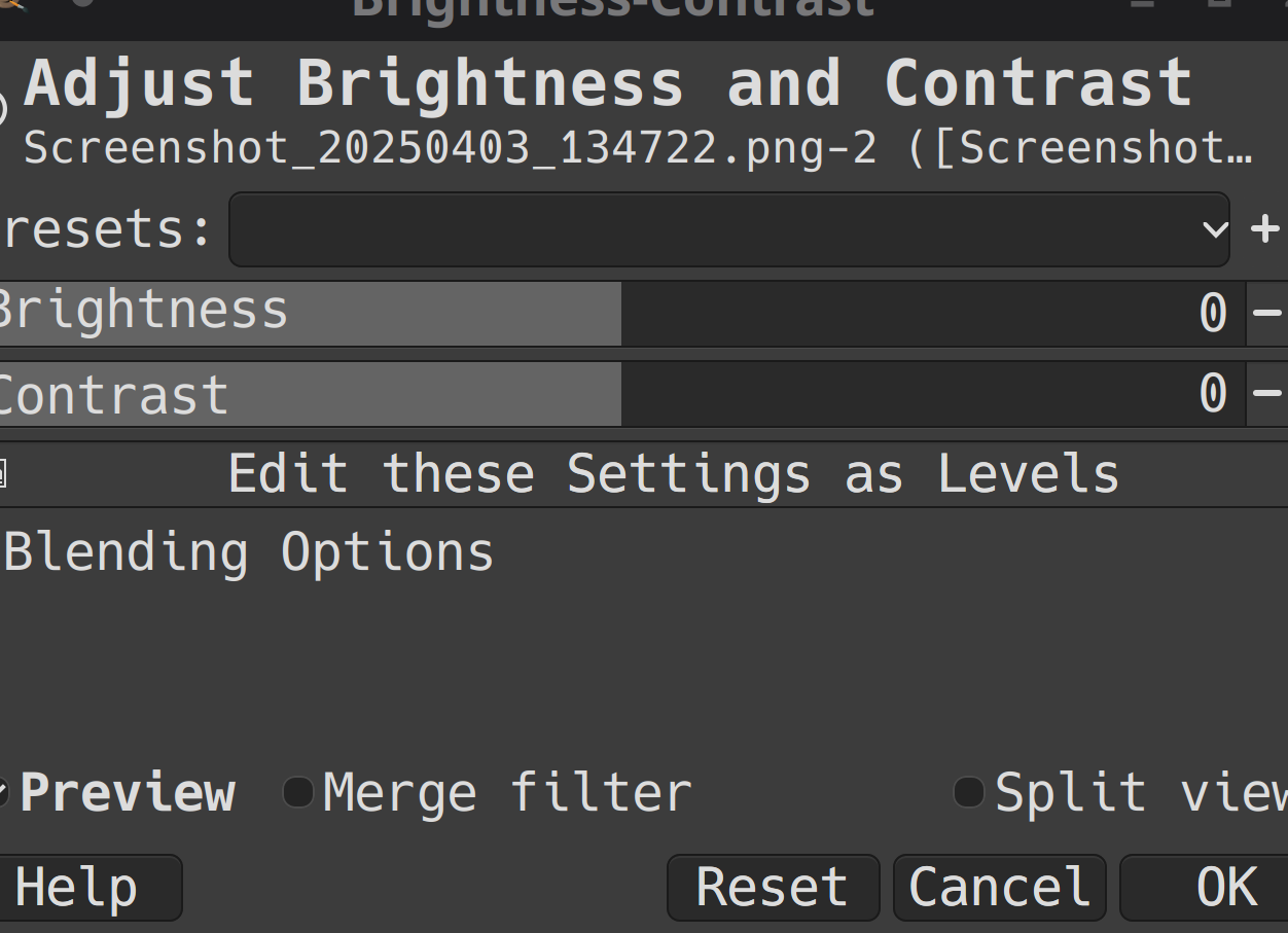

No, I mean the cancel, reset, save, etc buttons.
They are at the top of the window in Wayland? ![]()
Can you post a screenshot?
Hmm, according to the package information on nvidia-settings — which is what the screenshot is from, right? — that’s a gtk application.
I would still advise you to reboot. If the problem persists after the reboot, try it again with a freshly created user account and see if the problem exists there as well. If not, then it’s in the configuration of your main account somewhere.
Nope, that is Gimp. Here is a shot from X.
I thought Nvidia setting didn’t work in Wayland. The buttons are brighter in X also.

I think that is just the way GIMP does it (at least for now). You can read more in these discussions:
Yes, gimp is Wayland-aware now, but I have not actually used it for anything other than image resizing since the switch to gimp 3.0, so I hadn’t come across that issue with the buttons yet. ![]()
It’s not a big deal, I had not actually noticed. GIMP is a GTK app, so the fact that they are now using GTK3 instead of GTK2, means things change in line with the GTK3 changes from GTK2.
Oh, still kind of odd though. When I am using KDE in both X & Wayland.

It’s the client-side window decorations. gtk applications default to that under Wayland, even though you can generally tell them to use the window manager’s decorations, i.e. the ones installed for Plasma.
I have xdg-desktop-portal-kde installed but GIMP still uses gtk style for open image. Makes me wonder what else I need to change to get it to look like yours.
Ok, I don’t have gtk3-nocsd-git but I’m not going to bother with it since I rarely use GTK apps anyway.
Hmmm, well this is the XDG-* packages I have installed:

Well, I do have gtk3-nocsd-git installed:
$ pamac search --installed nocsd
gtk3-nocsd-git 3.0.8+2.r84.20221015.a356bf7-2 AUR
A LD_PRELOAD library to disable gtk+ 3 client side decoration.
And I’ve got this environment variable set in /etc/profile.d/environment_variables.sh (self-created file):
export LD_PRELOAD=/usr/lib/libgtk3-nocsd.so.0
