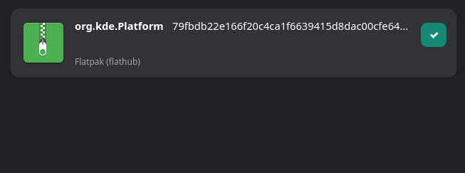

Annoying issue with add/remove software
this has been here for nearly a month now (I think) and it wont go away no matter what I so to it
all it says is this: Transaction successfully finished. and then reappears
anyone know why?
Old bug. Sometimes flatpak platform updates stick in the gui interface for some unknown reason.
Try from the command line
flatpak update
And by the way Pamac (Add-Remove) also installs the flatpaks with wrong permissions as root. :man_shrugging:
You could try performing a flatpak update from the command-line to see if that helps clear it up.
flatpak update
Ah ok ill give it a try
It worked as you can see thanks and sorry for waiting your time
