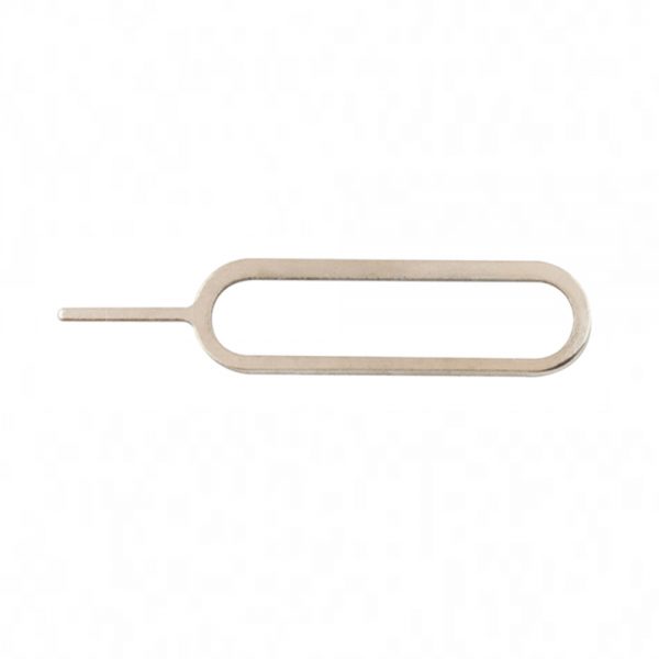

  4. Hold inn button beside IR port , a small hole ( I use iphone sim card tool)
Press and hold button when connecting micro-usb to X96s from pc.
