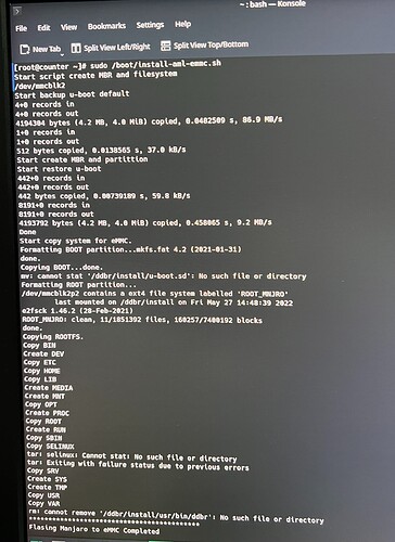

Hi, i am using i96 pro 4GB/32GB …i am running manjaro from micro SD card using dtbs- amlogic/meson-sm1-sei610.dtb
  1. I tried the default method - sudo /boot/install-aml-emmc.sh , this when run shows blank screen no output
  2. i tried download -@danboid - install-aml59.sh , u-boot-gsking-x.bin - this one throws MMC device 2 not found ,missing env variable bootfile , pxeuuid
  3. i tried third method - after using 1st method , created uEnvi.ini , UPDATED FSTAB with PARTUUID ,renamed u-boot.emmc /extlinux - blank screen at bootup
Which image did you use for this ?

1.image used - Manjaro-ARM-kde-plasma-vim3-21.03.img - if i remeber well , at sdcard boot-system info -shows -kernel 5.12.9-1-manjaro-arm
2. android 9.0 was present
3. the device is using S905X3
4. screenshot using default method( install-aml-emmc.sh)
This will not work. It uses Mainline uboot.
Use GTking or am6 image that should work and then run the install-emmc script.
This is not the latest script.Try as recommended above.

[    5.802744@0] hdmirx_ext: [hdmiin_drv_init] ver: Jul042016.1
[    5.806221@0] gxbb_pm: enter meson_pm_probe!
[    5.810276@0] gxbb_pm: meson_pm_probe done
[    5.815279@0] cpucore_cooling_register, max_cpu_core_num:4
[    5.819979@0] cpucore_cooling_register, max_cpu_core_num:4
[    5.840741@0] aml_istbt_dev_ready NULL
[    5.84079X    5.845524@0] meson_uart c81004c0.serial: ttyS0 use xtal(8M) 24000000 change 115200 to 115200
[    5.848947@0] Freeing unused kernel memory: 1248K (ffffffc001f47000 - ffffffc00207f000)
[    5.876578@0] init: init first stage started!
[    6.011931@6] audit: type=1403 audit(1420070408.710:2): policy loaded auid=4294967295 ses=4294967295
[    6.016192@6] init: (Initializing SELinux non-enforcing took 0.14s.)
[    6.026113@6] init: init second stage started!
[    6.030751@6] init: property_set("ro.boot.selinux", "permissive") failed
[    6.035536@6] init: Running restorecon...
[    6.129834@3] init: waitpid failed: No child processes
[    6.130201@3] init: (Loading properties from /default.prop took 0.00s.)
[    6.138382@3] init: (Parsing /init.environ.rc took 0.00s.)
[    6.141765@3] init: (Parsing /init.usb.rc took 0.00s.)
[    6.147257@3] init: /init.amlogic.rc: 237: chmod requires 2 arguments
[    6.154173@3] init: (Parsing init.amlogic.usb.rc took 0.00s.)
[    6.159060@3] init: (Parsing init.amlogic.usb.rc took 0.00s.)
[    6.164197@3] init: (Parsing init.amlogic.board.rc took 0.01s.)
[    6.170202@3] init: (Parsing init.amlogic.wifi.rc took 0.00s.)
[    6.175865@3] init: could not import file 'init.mtk.rc' from '/init.amlogic.rc': No such file or directory
[    6.185448@3] init: (Parsing /init.amlogic.rc took 0.04s.)
[    6.191565@3] init: (Parsing /init.usb.configfs.rc took 0.00s.)
[    6.196884@3] init: (Parsing /init.zygote64_32.rc took 0.00s.)
[    6.202490@3] init: (Parsing /init.rc took 0.07s.)
[    6.207307@3] init: aml-firstboot-init insert aml-firstboot-init
[    6.213772@3] init: Starting service 'ueventd'...
[    6.218625@3] init: insmod: open("/boot/optee.ko") failed: No such file or directoryinit: insmod: open("/boot/optee_armtz.ko") failed: No such file or directory[    6.228651@1] ueventd: ueventd started!
[    7.092954@3] ueventd: 肹    7.095467@4] meson_uart c81004c0.serial: ttyS0 use xtal(8M) 24000000 change 115200 to 115200
[    7.134417@4] fb: afbc: 1
[    7.135223@4] init: enter do_confirm_formated /dev/block/tee, /tee
[    7.137653@4] init: blocksize 1024, bytes_per_inode 1024
[    7.142816@4] init: do_confirm_formated ext4 try mount
[    7.150331@3] EXT4-fs (mmcblk0p8): warning: maximal mount count reached, running e2fsck is recommended
[    7.158276@3] EXT4-fs (mmcblk0p8): recovery complete
[    7.162047@3] EXT4-fs (mmcblk0p8): mounted filesystem with ordered data mode. Opts: noauto_da_alloc
[    7.207864@3] init: enter do_confirm_formated /dev/block/data, /data
[    7.208593@3] init: do_confirm_formated ext4 try mount
[    7.216843@3] EXT4-fs (mmcblk0p15): warning: maximal mount count reached, running e2fsck is recommended
[    7.223806@0] EXT4-fs (mmcblk0p15): recovery complete
[    7.228076@0] EXT4-fs (mmcblk0p15): mounted filesystem with ordered data mode. Opts: noauto_da_alloc
[    7.297646@4] init: enter do_confirm_formated /dev/block/cache, /cache
[    7.298548@4] init: do_confirm_formated ext4 try mount
[    7.306953@4] EXT4-fs (mmcblk0p3): warning: maximal mount count reached, running e2fsck is recommended
[    7.313295@4] EXT4-fs (mmcblk0p3): recovery complete
[    7.317795@4] EXT4-fs (mmcblk0p3): mounted filesystem with ordered data mode. Opts: noauto_da_alloc
[    7.382899@2] EXT4-fs (mmcblk0p12): mounted filesystem with ordered data mode. Opts: (null)
[    7.385781@2] fs_mgr: __mount(source=/dev/block/system,target=/system,type=ext4)=0
[    7.393799@2] EXT4-fs (mmcblk0p15): Ignoring removed nomblk_io_submit option
[    7.402917@2] EXT4-fs (mmcblk0p15): warning: maximal mount count reached, running e2fsck is recommended
[    7.409864@2] EXT4-fs (mmcblk0p15): mounted filesystem with ordered data mode. Opts: errors=remount-ro,nomblk_io_submit
[    7.420253@2] fs_mgr: check_fs(): mount(/dev/block/data,/data,ext4)=0: Success
[    7.457460@2] fs_mgr: check_fs(): unmount(/data) succeeded
[    7.458733@2] fs_mgr: Not running /system/bin/e2fsck on /dev/block/data (executable not in system image)
[    7.467272@2] EXT4-fs (mmcblk0p15): Ignoring removed nomblk_io_submit option
[    7.476524@2] EXT4-fs (mmcblk0p15): warning: maximal mount count reached, running e2fsck is recommended
[    7.483443@2] EXT4-fs (mmcblk0p15): mounted filesystem with ordered data mode. Opts: nodelalloc,nomblk_io_submit,errors=panic
[    7.494343@2] fs_mgr: __mount(source=/dev/block/data,target=/data,type=ext4)=0
[    7.503787@2] EXT4-fs (mmcblk0p3): Ignoring removed nomblk_io_submit option
[    7.511060@2] EXT4-fs (mmcblk0p3): warning: maximal mount count reached, running e2fsck is recommended
[    7.518054@2] EXT4-fs (mmcblk0p3): mounted filesystem with ordered data mode. Opts: errors=remount-ro,nomblk_io_submit
[    7.528259@2] fs_mgr: check_fs(): mount(/dev/block/cache,/cache,ext4)=0: Success
[    7.567783@2] fs_mgr: check_fs(): unmount(/cache) succeeded
[    7.567852@2] fs_mgr: Not running /system/bin/e2fsck on /dev/block/cache (executable not in system image)
[    7.577760@2] EXT4-fs (mmcblk0p3): Ignoring removed nomblk_io_submit option
[    7.586690@2] EXT4-fs (mmcblk0p3): warning: maximal mount count reached, running e2fsck is recommended
[    7.593709@2] EXT4-fs (mmcblk0p3): mounted filesystem with ordered data mode. Opts: nodelalloc,nomblk_io_submit,errors=panic
[    7.604578@2] fs_mgr: __mount(source=/dev/block/cache,target=/cache,type=ext4)=0
[    7.612469@2] EXT4-fs (mmcblk0p8): Ignoring removed nomblk_io_submit option
[    7.620508@2] EXT4-fs (mmcblk0p8): warning: maximal mount count reached, running e2fsck is recommended
[    7.629059@2] EXT4-fs (mmcblk0p8): mounted filesystem with ordered data mode. Opts: errors=remount-ro,nomblk_io_submit
[    7.638687@2] fs_mgr: check_fs(): mount(/dev/block/tee,/tee,ext4)=0: Success
[    7.687803@2] fs_mgr: check_fs(): unmount(/tee) succeeded
[    7.687871@2] fs_mgr: Not running /system/bin/e2fsck on /dev/block/tee (executable not in system image)
[    7.697446@2] EXT4-fs (mmcblk0p8): Ignoring removed nomblk_io_submit option
[    7.705399@2] EXT4-fs (mmcblk0p8): warning: maximal mount count reached, running e2fsck is recommended
[    7.713564@2] EXT4-fs (mmcblk0p8): mounted filesystem with ordered data mode. Opts: nodelalloc,nomblk_io_submit,errors=panic
[    7.724252@2] fs_mgr: __mount(source=/dev/block/tee,target=/tee,type=ext4)=0
[    7.732853@7] EXT4-fs error (device mmcblk0p12): ext4_readdir:221: inode #495: block 34685: comm init: path /system/etc/init: bad entry in directory: inode out of bounds - offset=0(0), inode=4181730297, rec_len=992, name_len=19
[    7.758425@4] Unable to find swap-space signature
[    7.758526@4] fs_mgr: swapon failed for /dev/block/zram0
[    7.763304@4] init: do_start: Service logd not found
[    8.243611@3] init: cannot find '/system/bin/tee-supplicant' (No such file or directory), disabling 'tee_supplicant'
[    8.250394@3] init: property_set("ro.adb.secure", "1") failed
[    8.254465@3] init: /recovery not specified in fstab
[    8.259448@3] init: do_start: Service debuggerd not found
[    8.264436@3] init: do_start: Service debuggerd64 not found
[    8.269970@3] init: do_start: Service vold not found
[    8.319926@0] init: cannot find '/system/bin/tzdatacheck' (No such file or directory), disabling 'exec 1 (/system/bin/tzdatacheck)'
[    8.329085@0] init: decode_uid: Unable to find UID for 'pppoe'. Returning UINT_MAX
[    8.334328@0] init: decode_uid: Unable to find UID for 'pppoe'. Returning UINT_MAX
[    8.347455@0] init: insmod: open("/system/lib/mali.ko") failed: No such file or directoryinit: insmod: open("/system/lib/dovi.ko") failed: No such file or directoryinit: do_start: Service logd not found
[    8.359736@0] init: do_start: Service logd-reinit not found
[    8.368071@0] init: cannot find '/system/bin/sh' (No such file or directory), disabling 'console'
[    8.374063@0] init: cannot find '/system/bin/systemcontrol' (No such file or directory), disabling 'system_control'
[    8.378942@1] binder: 4029:4029 transaction failed 29189, size 0-0
[    8.390685@0] init: cannot find '/system/bin/hdmi_cec' (No such file or directory), disabling 'hdmi_cec'
[    8.400687@0] init: insmod: open("/system/lib/aml_thermal.ko") failed: No such file or directoryinit: insmod: open("/system/lib/ddr_window_64.ko") failed: No such file or directory
[    8.420543@0] amlkey_init() enter!
[    8.422889@0] emmc_key_read:428, read ok
[    8.423117@0] amlkey_init() storagekey_info.buffer=ffffff8001900000, storagekey_info.size = 40000!
[    8.433135@0] vfm_map_store:rm default
[    8.435739@0] vfm_map_store:add default decoder ppmgr deinterlace amvideo
[    8.442531@0] init: insmod: open("/system/lib/dwc3.ko") failed: No such file or directory
[    8.451163@0] file system registered
[    8.455201@0] init: property 'sys.usb.state' doesn't exist while expanding '${sys.usb.state}'
[    8.462630@0] init: setprop: cannot expand '${sys.usb.state}'
[    8.468277@0] init: property 'ro.serialno' doesn't exist while expanding '${ro.serialno}'
[    8.476345@0] init: write: cannot expand '${ro.serialno}'
[    8.481888@0] init: property 'ro.usb.vendor.string' doesn't exist while expanding '${ro.usb.vendor.string}'
[    8.491366@0] init: write: cannot expand '${ro.usb.vendor.string}'
[    8.497550@0] init: property 'ro.usb.product.string' doesn't exist while expanding '${ro.usb.product.string}'
[    8.507311@0] init: write: cannot expand '${ro.usb.product.string}'
[    8.513558@0] init: property_set("ro.radio.noril", "true") failed
[    8.520496@0] fb: afbc: 1
[    8.522426@0] init: insmod: open("/system/lib/compat.ko") failed: No such file or directoryinit: insmod: open("/system/lib/qca80211.ko") failed: No such file or directoryinit: insmod: open("/system/lib/dwc3.ko") failed: No such file or directory
[    8.544914@0] ffs_data_put(): freeing
[    8.547476@0] init: property 'sys.usb.state' doesn't exist while expanding '${sys.usb.state}'
[    8.555777@0] init: setprop: cannot expand '${sys.usb.state}'
[    8.561582@0] init: property 'ro.serialno' doesn't exist while expanding '${ro.serialno}'
[    8.569587@0] init: write: cannot expand '${ro.serialno}'
[    8.575054@0] init: property 'ro.usb.vendor.string' doesn't exist while expanding '${ro.usb.vendor.string}'
[    8.584650@0] init: write: cannot expand '${ro.usb.vendor.string}'
[    8.590757@0] init: property 'ro.usb.product.string' doesn't exist while expanding '${ro.usb.product.string}'
[    8.600580@0] init: write: cannot expand '${ro.usb.product.string}'
[    8.607098@0] init: cannot find '/system/bin/tee-supplicant' (No such file or directory), disabling 'tee_supplicant'
[    8.617992@0] init: cannot find '/system/bin/update_verifier' (No such file or directory), disabling 'exec 2 (/system/bin/update_verifier)'
[    8.629723@0] init: cannot find '/system/bin/install-recovery.sh' (No such file or directory), disabling 'flash_recovery'
[    8.640510@0] init: cannot find '/system/bin/remotecfg' (No such file or directory), disabling 'remotecfg'
[    8.650115@0] init: cannot find '/system/bin/pppoe_wrapper' (No such file or directory), disabling 'pppoe_wrapper'
[    8.660345@0] init: cannot find '/system/bin/imageserver' (No such file or directory), disabling 'imageserver'
[    8.670277@0] init: cannot find '/system/bin/ddrtest.sh' (No such file or directory), disabling 'ddrtest'
[    8.679766@0] init: cannot find '/system/bin/factoryreset.sh' (No such file or directory), disabling 'factoryreset'
[    8.690171@0] init: cannot find '/system/bin/app_process64' (No such file or directory), disabling 'zygote'
[    8.699810@0] init: cannot find '/system/bin/app_process32' (No such file or directory), disabling 'zygote_secondary'
[    9.379302@1] binder: 4029:4029 transaction failed 29189, size 0-0
[   10.380418@5] binder: 4029:4029 transaction failed 29189, size 0-0
[   11.381484@5] binder: 4029:4029 transaction failed 29189, size 0-0
[   12.382515@5] binder: 4029:4029 transaction failed 29189, size 0-0
[   12.447537@5] random: nonblocking pool is initialized
[   13.383585@5] binder: 4029:4029 transaction failed 29189, size 0-0
[   14.384657@5] binder: 4029:4029 transaction failed 29189, size 0-0
[   15.385709@5] binder: 4029:4029 transaction failed 29189, size 0-0
[   16.387030@5] binder: 4029:4029 transaction failed 29189, size 0-0
[   17.388079@5] binder: 4029:4029 transaction failed 29189, size 0-0
[   18.389132@5] binder: 4029:4029 transaction failed 29189, size 0-0
[   19.390182@5] binder: 4029:4029 transaction failed 29189, size 0-0
[   20.391217@5] binder: 4029:4029 transaction failed 29189, size 0-0
[   21.392279@5] binder: 4029:4029 transaction failed 29189, size 0-0
[   22.393339@5] binder: 4029:4029 transaction failed 29189, size 0-0
[   23.394387@5] binder: 4029:4029 transaction failed 29189, size 0-0
[   24.395449@5] binder: 4029:4029 transaction failed 29189, size 0-0
[   25.396908@5] binder: 4029:4029 transaction failed 29189, size 0-0
[   26.397971@5] binder: 4029:4029 transaction failed 29189, size 0-0
[   27.399073@5] binder: 4029:4029 transaction failed 29189, size 0-0
[   28.400148@5] binder: 4029:4029 transaction failed 29189, size 0-0
[   29.401206@5] binder: 4029:4029 transaction failed 29189, size 0-0
[   30.402272@5] binder: 4029:4029 transaction failed 29189, size 0-0
[   31.403320@5] binder: 4029:4029 transaction failed 29189, size 0-0
[   32.404384@5] binder: 4029:4029 transaction failed 29189, size 0-0
[   33.405438@5] binder: 4029:4029 transaction failed 29189, size 0-0
[   34.406643@5] binder: 4029:4029 transaction failed 29189, size 0-0
[   35.407716@5] binder: 4029:4029 transaction failed 29189, size 0-0
[   36.408754@5] binder: 4029:4029 transaction failed 29189, size 0-0
[   37.409806@5] binder: 4029:4029 transaction failed 29189, size 0-0
Android startup TTL interrupt setting Usb startup
setenv bootfromrecovery 0
setenv bootfromnand 0
setenv start_mmc_autoscript 'if fatload mmc 0 11000000 s905_autoscript; then autoscr 11000000; fi;'
setenv start_usb_autoscript "if fatload usb 0 11000000 s905_autoscript; then autoscr 11000000; fi; if fatload usb 1 11000000 s905_autoscript; then autoscr 11000000; fi;"
setenv start_autoscript 'if usb start; then run start_usb_autoscript; fi; if mmcinfo; then run start_mmc_autoscript; fi;'
setenv bootcmd 'run start_autoscript; run storeboot'
setenv firstboot 1
saveenv
Usb startup log
GXM:BL1:dc8b51:76f1a5;FEAT:ADFC318C:80;POC:3;RCY:0;EMMC:0;READ:0;0.0;CHK:0;
TE: 90840
BL2 Built : 11:58:42, May 27 2017.
gxl gc3c9a84 - xiaobo.gu@droid05
set vdd cpu_a to 1120 mv
set vdd cpu_b to 1050 mv

Manjaro Linux 5.11.1-1-MANJARO-ARM (ttyAML0)
S912 login:
This image is not to be used on generic tv boxes.
Flash Android again on the device.
Use an image from here:
  • Flash image to sdcard.
  • Change dtb filename in uEnv.ini in boot partition to suite your device dtb.
  • Boot from sdcard.
  • Update Date time.
  • Run install script as root.
  • Reboot with Sdcard insert.
  • Boot into SDCard once.
  • Reboot with sdcard removed.
Hopefully it should work and if it does not then maybe there is some other undocumented problem with this device.

Manjaro-arm-xfce-vim2-21.02
I can use it to start the desktop and use it normally
I test manjaro-arm-kde-plasma-vim2-22.04
Flash image to Usb disk
Convert partition to MBR
Use u-boot.ext can also be started and used normally
I think vim2 is more suitable for my box
I stubbornly want to use EMMC to run my box
I used install-manjaro.emmc.sh to install but failed.
I need your help
I’m from China.
I need to translate English
May not be accurate enough
I hope you can understand
Please use am6 image so I can help you find the issue.
If you use vim2 then i cannot help as it uses different boot process and that will never ever work from emmc on tv boxes.
Try again each step mentioned here.
Flash Android first.
Boot into android.
Boot into am6 image
And reply your feedback on each step so we can identify the issue on boot process.
If you give me random boot log without explaining what exactly your doing then it will be impossible for me to help you.
I don’t know what went wrong. Not working properly
Yes, I brush in Android first. Android works normally.
Use manjaro-arm-xfce-am6-plus-22.04 img. xz Flash image to sdcard. I used a 16GB SD .
Start from SD using TTL interrupt settings.
setenv firstboot 1
saveenv
Cannot boot from SD card
I found that it was the GPT partition table. I changed it to the MRT partition table
Modify uEnv.ini
dtb_name=/dtbs/amlogic/meson-gxm-q200.dtb
bootargs=root=LABEL=ROOT_MNJRO rootdelay=5 rootflags=data=writeback rw console=ttyAML0,115200n8 console=tty0 no_console_suspend consoleblank=0 fsck.fix=yes fsck.repair=yes net.ifnames=0 quiet splash plymouth.ignore-serial-consoles
It can be started from the SD card but the system error is entered
Below are error photos and TTL logs

   Image Name:   uInitrd Image
   Image Type:   AArch64 Linux RAMDisk Image (uncompressed)
   Data Size:    8478294 Bytes = 8.1 MiB
   Load Address: 00000000
   Entry Point:  00000000
   Verifying Checksum ... OK
load dtb from 0x1000000 ......
      Amlogic multi-dtb tool
      Single dtb detected
## Flattened Device Tree blob at 01000000
   Booting using the fdt blob at 0x1000000
   Loading Kernel Image(COMP_NONE) ... OK
   kernel loaded at 0x01080000, end = 0x02bfba00
libfdt fdt_path_offset() returned FDT_ERR_NOTFOUND
[rsvmem] fdt get prop fail.
   Loading Ramdisk to 73690000, end 73ea5e56 ... OK
   Loading Device Tree to 000000001fff2000, end 000000001ffff369 ... OK
fdt_instaboot: no instaboot image
Starting kernel ...
uboot time: 6244110 us
[    0.634021] hub 2-0:1.0: config failed, hub doesn't have any ports! (err -19)
domain-0 init dvfs: 4
domain-1 init dvfs: 4
[    1.170974] meson-drm d0100000.vpu: Failed to find CVBS Connector bridge
[BL31]: tee size: 0
[    8.080693] panfrost d00c0000.gpu: dev_pm_opp_set_regulators: no regulator (mali) found: -19
[    8.514688] debugfs: Directory 'c1105400.audio-controller' with parent 'P230-Q200' already present!
[    8.518141] debugfs: Directory 'c1105400.audio-controller' with parent 'P230-Q200' already present!
Press Enter for maintenance
Tips:Sorry, you can’t embed media items in a post.
Screen display
[ 0.632433 hub 2-0:1.0: config failed, hub doesn’t have any ports! (err -19)
Starting version 250.4-2-arch
[1.139777] meson-drm d0100000.vpu: Failed to find CVBS Connector bridge
You are in emergency mode. After logging in, type " journalctl -xb" to view
system logs, “systemctl reboot” to reboot, “systemctl default” or “exit”
to boot into default mode.
(or press Control-D to continue) :
I understand much better now.
This shows that the boot process is working fine.
Kernel is loading but I suspect that the rootfs is not found. Most likely cause sdcard configuration is different in the dtb used.
I think you need to try a different dtb why don’t you use vim2 dtb as it have worked for you before.
Also update the uEnv.ini to this content
bootargs=root=LABEL=ROOT_MNJRO rootdelay=5 rootflags=data=writeback rw console=ttyAML0,115200n8 console=tty0 no_console_suspend consoleblank=0 fsck.fix=yes fsck.repair=yes net.ifnames=0 earlycon loglevel=7
After this try to boot and share the log.
We will get better log with this
I have been using meson-gxm-q200.dtb configuration startup
Vim2 image is also meson-gxm-q200.dtb
Take your advice
I’ll try other DTB files to test
Expect me to succeed
Don’t forget to add these to uEnv.ini file to get more logs.
I tried manjaro on X96S but USB Keyboard and mouse not working, which DTB and kernel are you using for detecting USB in X96S ? Please help me in it, I am stuck …
