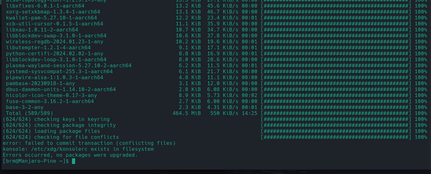

Hi all. The Pinebook-Pro Laptop has been refreshed. Tow-Boot has been installed and Manjaro from the image Manjaro-ARM-kde-plasma-generic-23.02.img.xz has been installed. This works well.
However the system is telling me it now has 506 updates awaiting. Using pacman -Syyu (then -Syu second try) to update, I encountered dozens of y/n questions and a very long update process. I have paused this as my last attempt failed. Is there a better way?

Any ideas on how to proceed? Is it just a matter of removing
/etc/xdg/konsolerc ?
