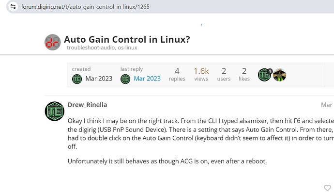

This is my first time using alsamixer so my apologies if I am asking a stupid question. In my project I use a Raspberry Pi and a HiFiberry DAC ADC PRO+ to send data through a device, and record it back so I can analyze this. I ran into problems because of the AGC(Automatic gain control) that automatically transfers whatever signal is sent into it to a value between 0 and 1. I need to disable this but haven’t found this setting in the alsamixer, I typed alsamixer pressed F6 selected my device but I see no setting here that talks about the AGC. On the picture of another forum they talk about this setting being available. Anyone have any ideas?

Later comment on Digirig forum has a screenshot showing all 4 ALSA controls including AGC switch
Auto Gain Control in Linux? - #4 by eYeToEyeRob
