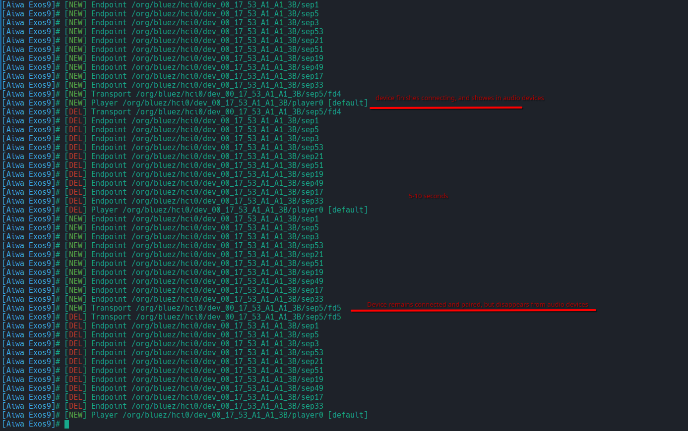

Hello, I recently ran a 1.4gb system update, and just as the title says, a specific bluetooth speaker is not working. I am able to pair and connect, but after 3-10 seconds, the device disappears from my audio devices. I don’t really know what I’m doing, but everything seems fine until i get “unknown errors”

:pray: I wish to delete this post it seems my problem was external… Even though I restarted the speaker previously, it seems the combination of re-installing pulseaudio and removing the battery from the speaker worked. Pulseaudio was reinstalled, and at that point, I gave the battery back, and it connected without any weird behavior or errors. I noticed that the deviceid was saved even though I tried to delete it, though. I can only speculate what the issue was
that forced a reset of the controller from the speaker and the creating of a complete new pairing-key. highly possible that the previous pairing-key was failing.
is there an easy way to do this though manjaro? its happening again :S it worked until pc went into sleep mode

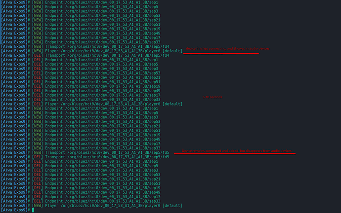

I didn’t mention it but it seems to add the devices to the list even if it says it “fails” to connect… It disconnects, connects again, then disconnects
