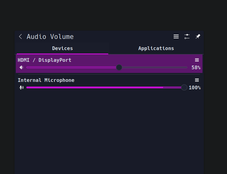

Yesterday I did an update and after that my microphone and speaker don’t work.
If I go to Google Meet for example, I can listen the people or in youtube the videos but If I go to zoom or slack is not working.
In google meet the people cannot hear me either. I have checked everything and I don’t know what I need to do. Everything is like always:
