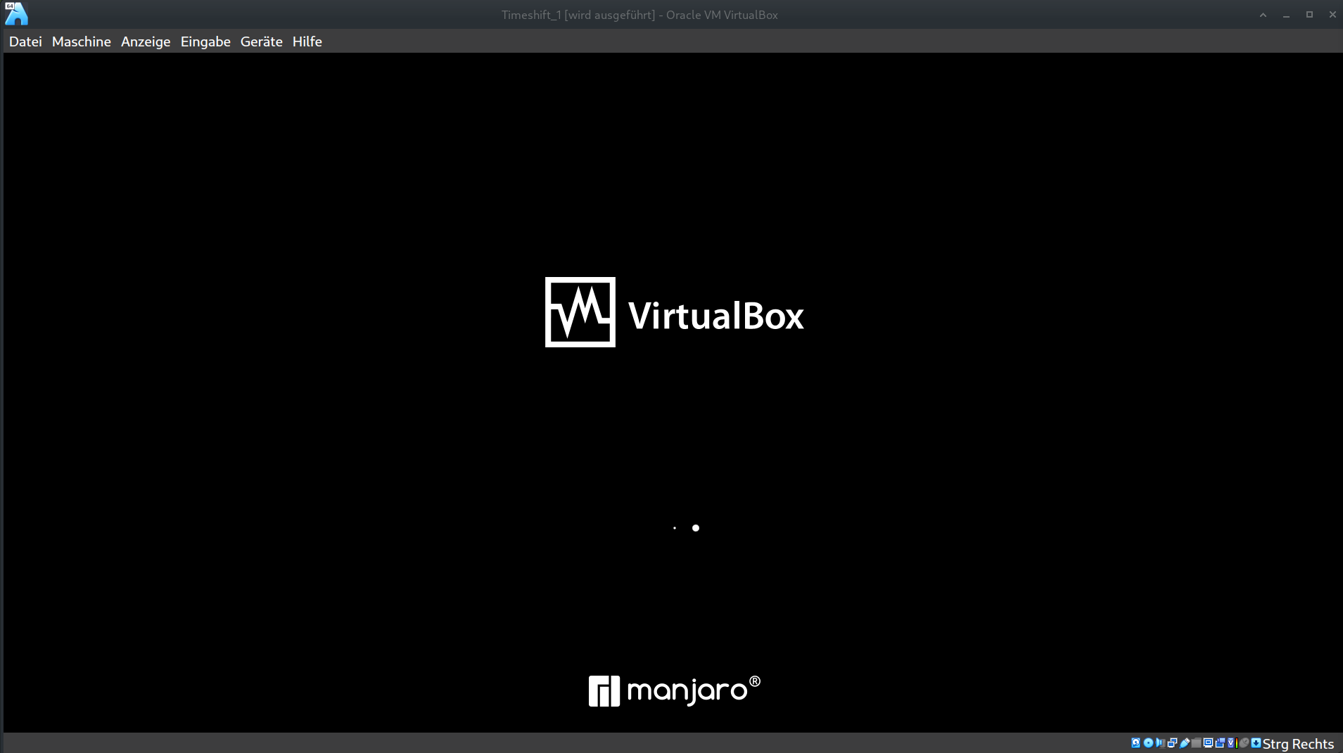

After an update my virtual machine does not boot into xfce any more. This is a fresh vm from today.
Steps to reproduce:
  • Use virtualbox (up to date 7.0.8 r156879)
  • manjaro-xfce-22.1.3-230529-linux61.iso
  • boot and run installer
    • efi-install
    • 1GB fat as /boot/efi, 200GB btrfs as /
  • boot into vm
    Until now everything works !
  • reboot vm
  • press ESC to get into grub
  • boot into timeshift-snapshot from before the update
  • everything works
:woozy_face:
edit:
pressing F12 while booting led to one successfull boot :flushed:
edit:
next boot, no such luck :man_shrugging:
pressing F12 while the kernel starts leads to success
If I don’t disturb the kernel when booting, I don’t end up in the GUI, just have the boot animation forever. No further reaction, neither to function keys, nor mouse or keyboard.
If F12 is pressed several times during boot, the kernel boot log becomes visible. The screen flips several times, but ends up in xfce. After that everything is normal

To work around the problem, I now saved the VM in the running state. Even if I have to reinstall something, I will avoid every boot as far as possible.
That’s enough for my investigations
:footprints:
I know there is some huddlihut with plymouth and virtualbox vm - I don’t know what it is but I know what workaround to apply.
  1. Restart your vm - and hit Esc to enter too Grub menu.
  2. Edit your command and remove quiet, splash and udev.log_priority=3 - press F10 to boot the vm.
  3. Edit your /etc/default/grub and edit the command to remove the above arguments.
  4. Save and rebuild your grub config grub-mkconfig -o /boot/grub/grub.cfg
Did these 2 steps. Reboot was successful at first try. :smiling_face_with_three_hearts:
