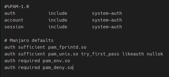

Does my file have to look exactly like yours because it came up in a different way in my pam.d file. LIke this:
This is after I reordered according to your post. I still get asked for password first (which I have to type it in, just pressing enter doesn’t work) and then my fingerprint.
Do I have to remove the Manjaro defualts line and move the bottom auth lines to the top?
Thanks.
#%PAM-1.0
auth       sufficient   pam_fprintd.so
auth       include      system-auth
account    include      system-auth
session    include      system-auth
Something like this should work.
