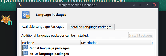

Hi,
I can’t find the German (Deutsch) locale (language pack) in
Manjaro Settings Manager > Locale Settings > Add Locale
on Manjaro XFCE
I want my system in German (Deutsch), but it’s not available anymore. I remember it used to be available, but I may have updated the /etc/locale.gen after an update.
Why is Germany not available anymore in Manjaro Settings Manager as a language? I thought Manjaro even has German developers?
Crazy that I can choose even the most exotic languages I didn’t even know existed, but I can not choose good old German.

That is because you misunderstand the purpose of it.
It is designed to install the language packs matching the installed locales - nothing else.
When you have the language packs installed for the installed locales - then you cannot install language packages in the settings manager.
If you want to stay in the settings manager - then you need to add a new locale - only then you will able to install the language packs for the newly installed locale.
But you can install all you want - just use Add / Remove Software - search for the langauge code - then select and install.

it is strange that the “Deutsch” locale would be missing.
The terminal way to check:
grep -v ^# /etc/locale.gen
the output should contain a line:
de_DE.UTF-8 UTF-8
If it doesn’t, you can edit the file and remove the # in front of the line
or add that to the end of the file
afterwards:
sudo locale-gen
The easy way (but a waste of space) is what @linux-aarhus just said:
sudo pacman -Syu glibc-locales
One could speculate if glibc locales is dysfunctional on your system.
There is a package with all locales (if I recall correct)

de_DE.UTF-8 UTF-8
This line is not even present in the locale.gen file.
The strange thing is, I previously had German (Deutsch) installed.
Next thing im gonna do is reinstall glibc-locales as Aarhus suggests
I’d say:
try putting it in there - but it really should be there already - just commented out
The file /etc/locale.gen is part of glibc
Perhaps there is a .pacnew file you did not merge?
No, there is no new pacnew file.
de_DE.UTF-8 UTF-8
is not present in /etc/locale.gen at all
I reinstalled glibc-locales
whatthe:
de_DE.UTF-8 UTF-8
If you search for the above you won’t find if it is uncommented
lf this is also returning nothing then your locale.gen file is damaged.
$ grep -e 'de_DE' /etc/locale.gen
#de_DE.UTF-8 UTF-8
#de_DE ISO-8859-1
#de_DE@euro ISO-8859-15
There was no output
This is my locale.gen:

whatthe:
It is incomplete the first part of the file is missing.
This is you missing part - therefore you have no de_DE - perhaps other parts are missing - I have not checked - but you have definately edited the file - a GUI editor as root perhaps - accidently marked a section and delete (poof)
# Configuration file for locale-gen
# lists of locales that are to be generated by the locale-gen command.
# Each line is of the form:
# <locale> <charset>
# where <locale> is one of the locales given in /usr/share/i18n/locales
# and <charset> is one of the character sets listed in /usr/share/i18n/charmaps
# The locale-gen command will generate all the locales,
# placing them in /usr/lib/locale.
# A list of supported locales is given in /usr/share/i18n/SUPPORTED
# and is included in this file. Uncomment the needed locales below.
#de_AT.UTF-8 UTF-8
#de_AT ISO-8859-1
#de_AT@euro ISO-8859-15
#de_BE.UTF-8 UTF-8
#de_BE ISO-8859-1
#de_BE@euro ISO-8859-15
#de_CH.UTF-8 UTF-8
#de_CH ISO-8859-1
#de_DE.UTF-8 UTF-8
#de_DE ISO-8859-1
#de_IT.UTF-8 UTF-8
#de_IT ISO-8859-1
#de_LI.UTF-8 UTF-8
#de_LU.UTF-8 UTF-8
#de_LU ISO-8859-1
#de_LU@euro ISO-8859-15
#en_IN UTF-8
#en_NG UTF-8
#en_NZ.UTF-8 UTF-8
Your file start
#en_NZ ISO-8859-1
#en_PH.UTF-8 UTF-8
#en_PH ISO-8859-1
#en_SC.UTF-8 UTF-8
#en_SG.UTF-8 UTF-8
#en_SG ISO-8859-1
en_US.UTF-8 UTF-8
#en_US ISO-8859-1
#en_ZA.UTF-8 UTF-8
#en_ZA ISO-8859-1
#zu_ZA.UTF-8 UTF-8
#zu_ZA ISO-8859-1
It returns nothing, so my locale.gen is indeed damaged I believe.
I don’t have calamares installed, but I do have calamares-tools installed
Likely that won’t help.
(but I don’t know where the manjaro settings manager get’s it’s input from)
Why?
Installing glibc-locales will not touch this file.
It just provides all the locales - not the configuration file.
a reinstallation of glibc should at least generate a .pacnew file
or just extract it from the package
or use the sample @linux-aarhus posted
or just edit the file and put it in there
something happened - the file does not contain everything it should contain
When you initially installed the system - the installer (Calamares) added the chosen locale to the bottom of the file.
Thank you guys, I think my locale.gen file got corrupted somehow. I did not know how to generate a fresh one. Thanks to @linux-aarhus I copied his locale.gen as a template for my own and regenerated with sudo locale-gen
