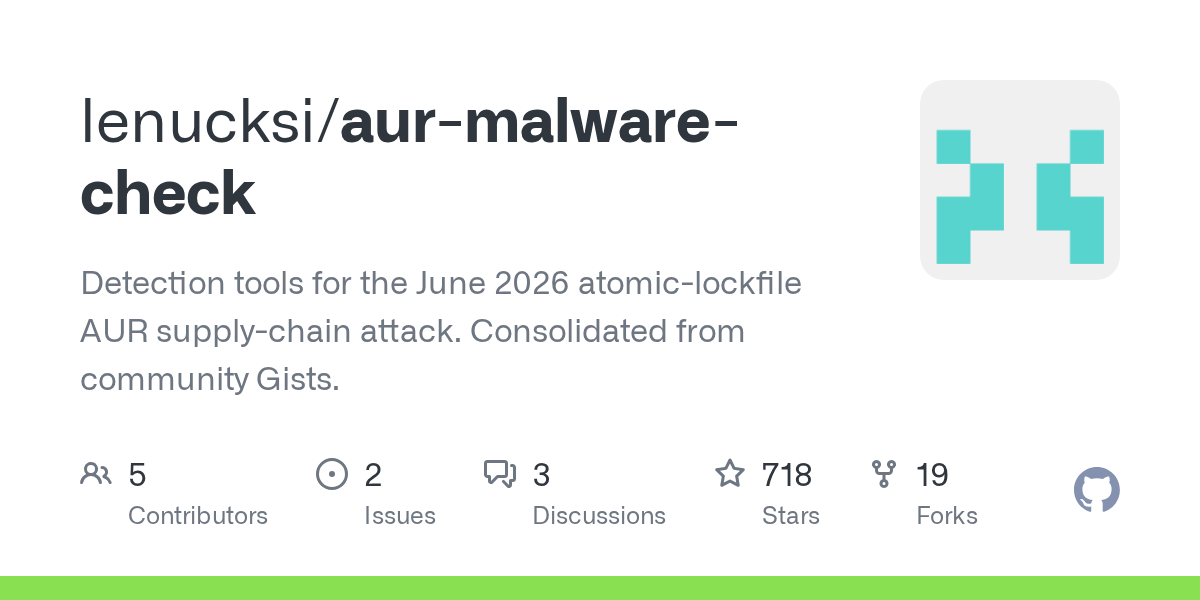

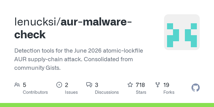

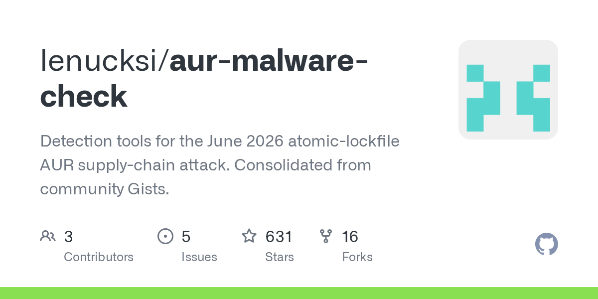

I think the most comprehensive script stays this one
Is constantly updated and currently includes indicators from many other forks if you run it with --full
Note that it uses database files in the repo so it is best to clone the repo with
git clone https://github.com/lenucksi/aur-malware-check.git
cd aur-malware-check
chmod +x aur_check-v2.sh
./aur_check-v2.sh --full
periodically update and run from its folder with
git pull
./aur_check-v2.sh --full --refresh -v
