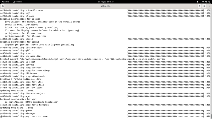

well that sucks, looks like manjaro-arm-installer sway is broken, going to have to do a minimal & build up.
guess I’m done with sway, no install options for my rpi400. i messed up my working version.
the version 20 has no wifi & the manjaro-arm-installer is broken.
i can do an xfce install & add sway, but thats not the same.
maybe i go back to I3?

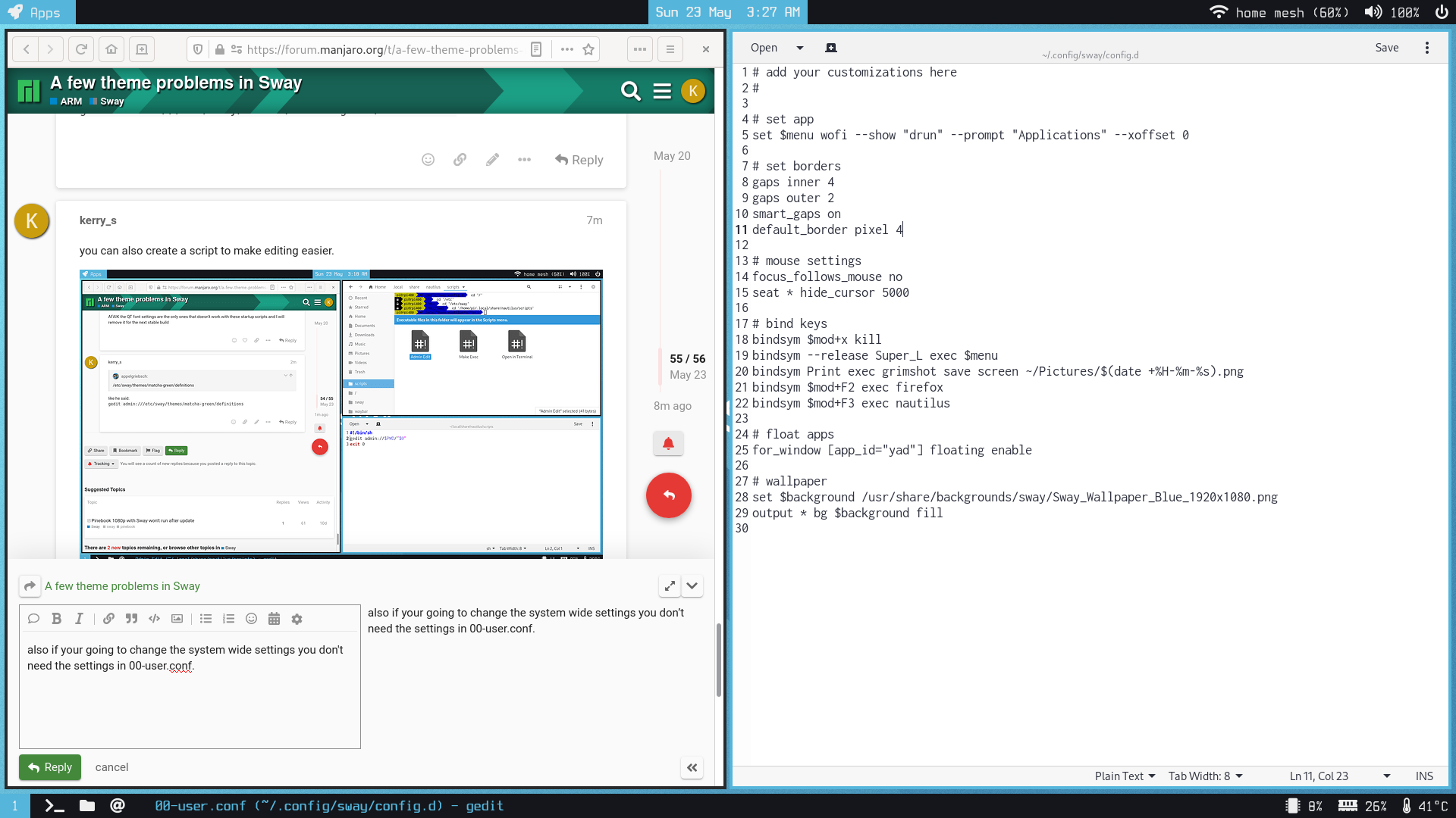

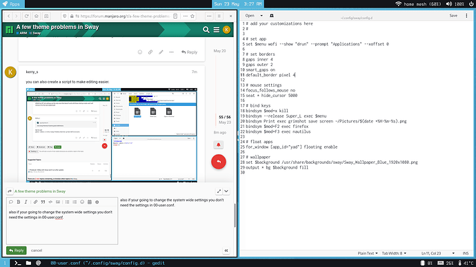

add this to your to your 00-user.conf, then save, then alt+shift+c to reload, then you can use the print key for screen shots, there saved in pictures.
bindsym Print exec grimshot save screen ~/Pictures/$(date +%H-%m-%s).png
sway just takes time to learn, most of it is editing the file correctly.

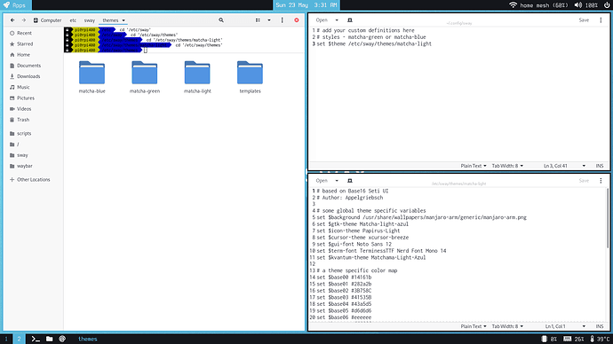

The font configuration is done in various places: there are GTK 2/3 font settings, QT font settings, waybar and termite/foot terminal font settings…
So we have check each of them individually. The default configuration is defined in /etc/sway/themes/matcha-green/definitions. It defines 2 variables: gui-font and term-font. During the log in process the scripts in /etc/sway/config.d/ get executed and uses those variables and the templates in /etc/sway/themes/templates to create the following config files in your user folder:
$HOME/.gtkrc-2.0,
$HOME/.config/gtk-3.0/settings.ini,
$HOME/.config/gtk-4.0/settings.ini,
$HOME/.config/qt5ct/qt5ct.conf
So either you change the values in those theme defaults or you disable these startup scripts and maintain the existing copies in your user folder manually…
AFAIK the QT font settings are the only ones that doesn’t work with these startup scripts and I will remove it for the next stable build
like he said:
gedit admin:///etc/sway/themes/matcha-green/definitions
you can also create a script to make editing easier.
also if your going to change the system wide settings you don’t need the settings in 00-user.conf.
I might opt-in to move all startup scripts from /etc/sway/config.d to $HOME/.config/sway/config.d/ with the next release so it will be easier to adapt them to your needs…
i have mine setup the way you suggested. i copied the matcha-blue folder & just changed the dark to light
