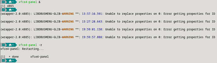

One additional tidbit of information:
Since I had xfce4-panel started from a shell today, I got these error messages from the process when the screen went to sleep:
Update: Definitely unrelated.

I have no opinion on it - it was not errors - it was warnings.
Was there any problem because of it?
Likely not …
These warnings came while the display was off. And after I woke it up, the panel was gone again. I don’t know if the warnings are related to my problem or not. Just thought it might ring a bell for someone.
