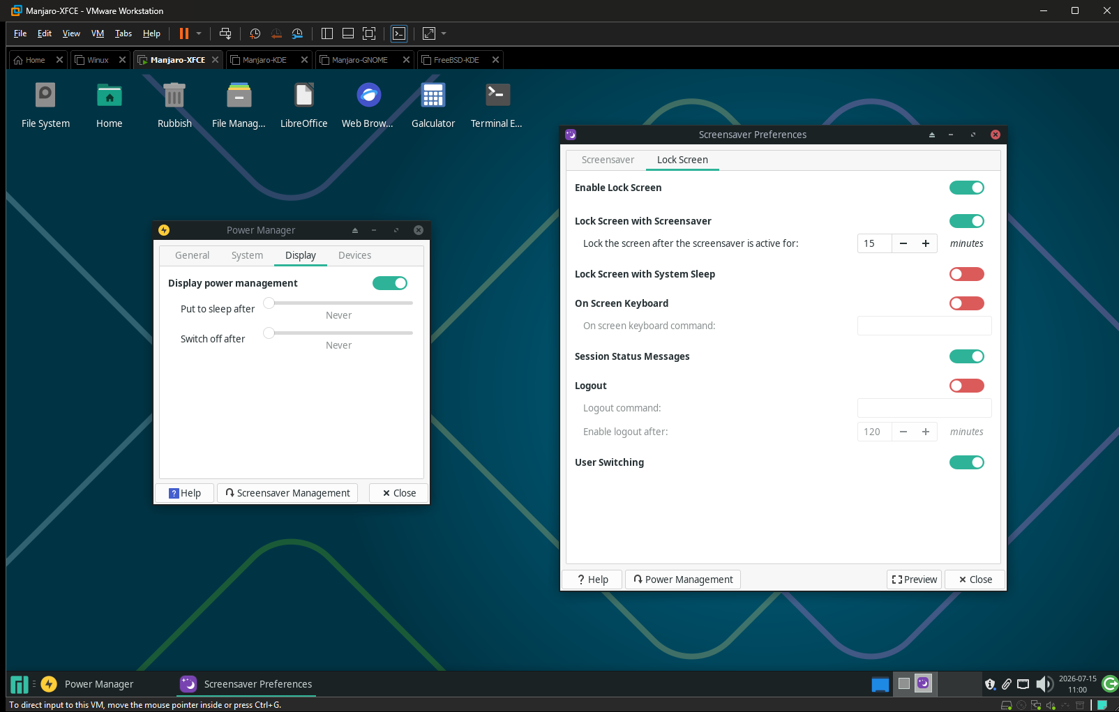

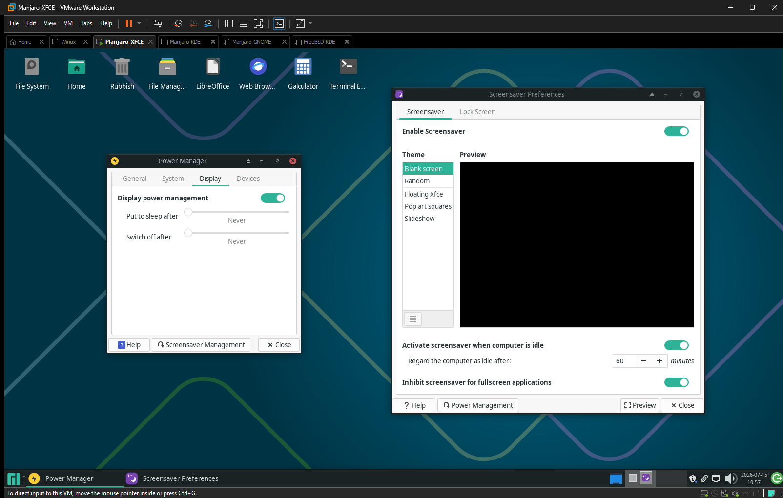

There are three areas to control various aspects of screen blanking; it’s important to be aware of these and to ask questions that reference the controls correctly, so that others can better understand your difficulty.
Please find (below) screenshots of the relevant controls for configuring your Power Management, Screen Saver blanking and Lock Screen preferences.
Note that there are no other applicable options to configure within the GUI of XFCE.
  • Power Manager → Display
  • Screensaver Preferences → Screensaver → Blank screen
  • Screensaver Preferences → Lock Screen
