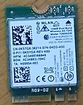

The first step is to look into the belly of the beast.
Identify whether it uses 2 or 3 antennas - but from the images I could find it has two connectors.
It is also important to determine the correct size of the replacement as the cards come in different shapes.
Then look for something similar.
I have an Intel 7265NGW - you can have it for postage fee.
