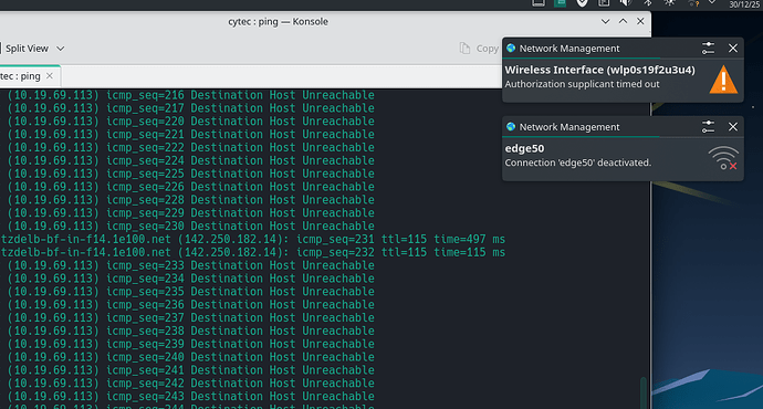

Post update, I perform a restart and the System comes back with the new Software packages etc. I login, and then start a Terminal for ping requests to google, and approximately about 2-3 mins later, the packets start dropping and I get the Notification that “authorization supplicant timed out” (see image uploaded) and Network goes off - only to return back in like 30 secs and then going back disconnected in 1-2 mins
