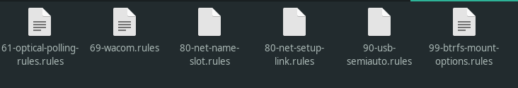

Do you think I can copy the etc/udev rules form MX to Manjaro with no issues?
Both are XFCE and systemd.
MX is based on Debian.
In theory that should be possible. But you know what they say… :backhand_index_pointing_down:
“In theory, theory and practice are the same thing. In practice, they are not.”
:stuck_out_tongue:

etc/dev/rules.d folder in manjaro is empty.
In Mx Linux the same folder has:
Why a screenshot when you can do the same with ls and get an output that can be indexed, searched and copy/pasted?
Anyway, they are all plain text files, so inspect them, and then you can try copying them over and see what it does.
