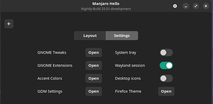

It is fairly simple to enable / disable wayland.
When funny things happen - switch to testing or unstable branch.
Open Manjaro Hello - click the Layouts button - click the Settings tab
Of course you need to restart user-space
systemctl soft-reboot
Thank you @linux-aarhus : wayland solved for me the OP!
