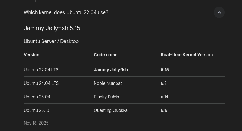

the answer is so easy. Well ,my previous OS was another fork of Linux, but that was based on Ubuntu 22.04 so according to Google, which Kernel it use by default? and that’s Kernel 5.15 so it’s really posible if i install this kernel on the latest Manjaro my old driver card will be not some waste metal in my pc :upside_down_face:

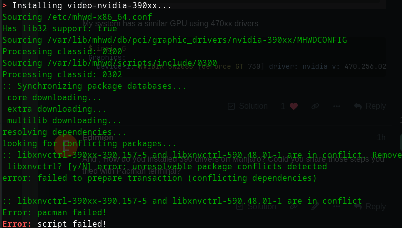

Sadly, I missed something .It gave me another error message Happily this time I copy and i can share that message:
Starting
> Using config ‘video-nvidia-390xx’ for device: 0000:01:00.0 (0300:10de:0f02) Display controller nVidia Corporation GF108 [GeForce GT 730]
> Installing video-nvidia-390xx…
Sourcing /etc/mhwd-x86_64.conf
Has lib32 support: true
Sourcing /var/lib/mhwd/db/pci/graphic_drivers/nvidia-390xx/MHWDCONFIG
Processing classid: 0300
Sourcing /var/lib/mhwd/scripts/include/0300
Processing classid: 0302
:: Synchronizing package databases…
core downloading…
extra downloading…
multilib downloading…
resolving dependencies…
looking for conflicting packages…
:: libxnvctrl-390xx-390.157-5 and libxnvctrl-590.48.01-1 are in conflict. Remove libxnvctrl? [y/N] error: unresolvable package conflicts detected
error: failed to prepare transaction (conflicting dependencies)
Error: pacman failed!
Error: script failed!
Done …

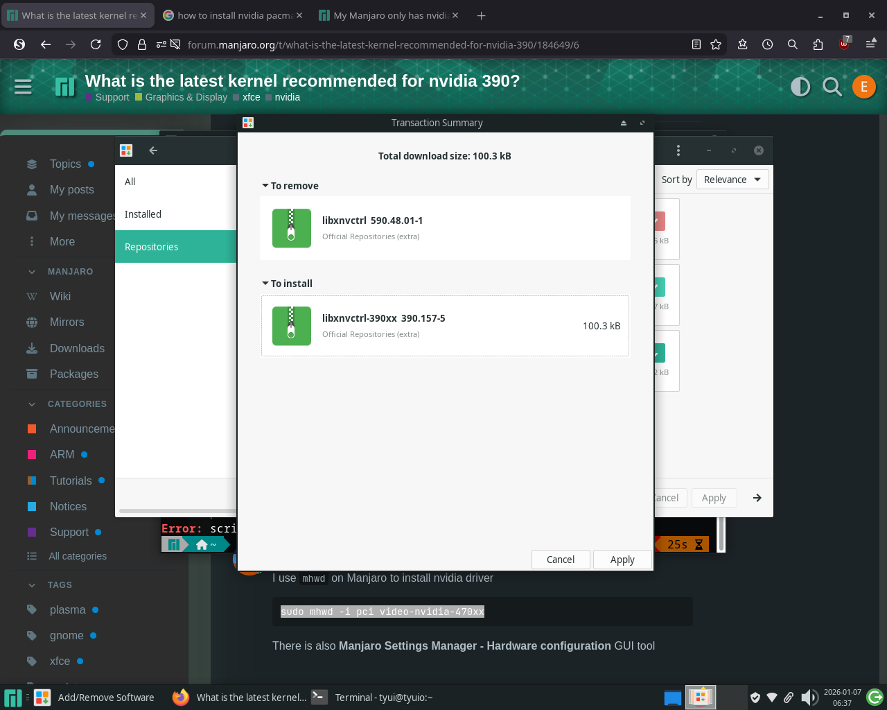

Well, finally was kind of tricky because my system didn’t allow me to install my property drivers 390 with this instruction sudo mhwd -i pci video-nvidia-390xx. Pacman gave me an error message that I have a 590nvidia plugin that depends on xfce4-sensors-plugin so I couldn’t install my 390 driver.
So, in the end Add/Remove software I install the old version (390) of libxnvcrt instead of the lastest by default. I run again the first instruction and all was ok. I’ll update the first message with a review
