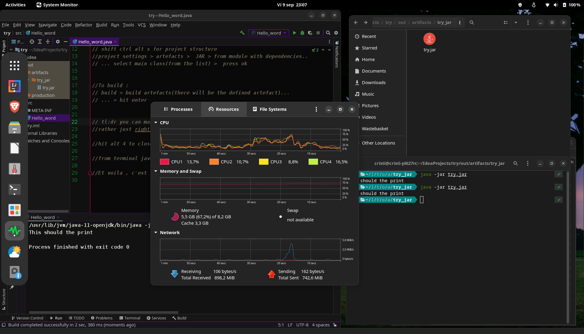

What happens if I run out of ram in my case?
So I was just starting to work with intelij ideea With java and the java managed to use 2 gb ram
Should I consider buying 8 gb more in the future?
Like I’m kinda worried to the outcome of not having swap(my bad when I installed it and ran home without thinking too much):
