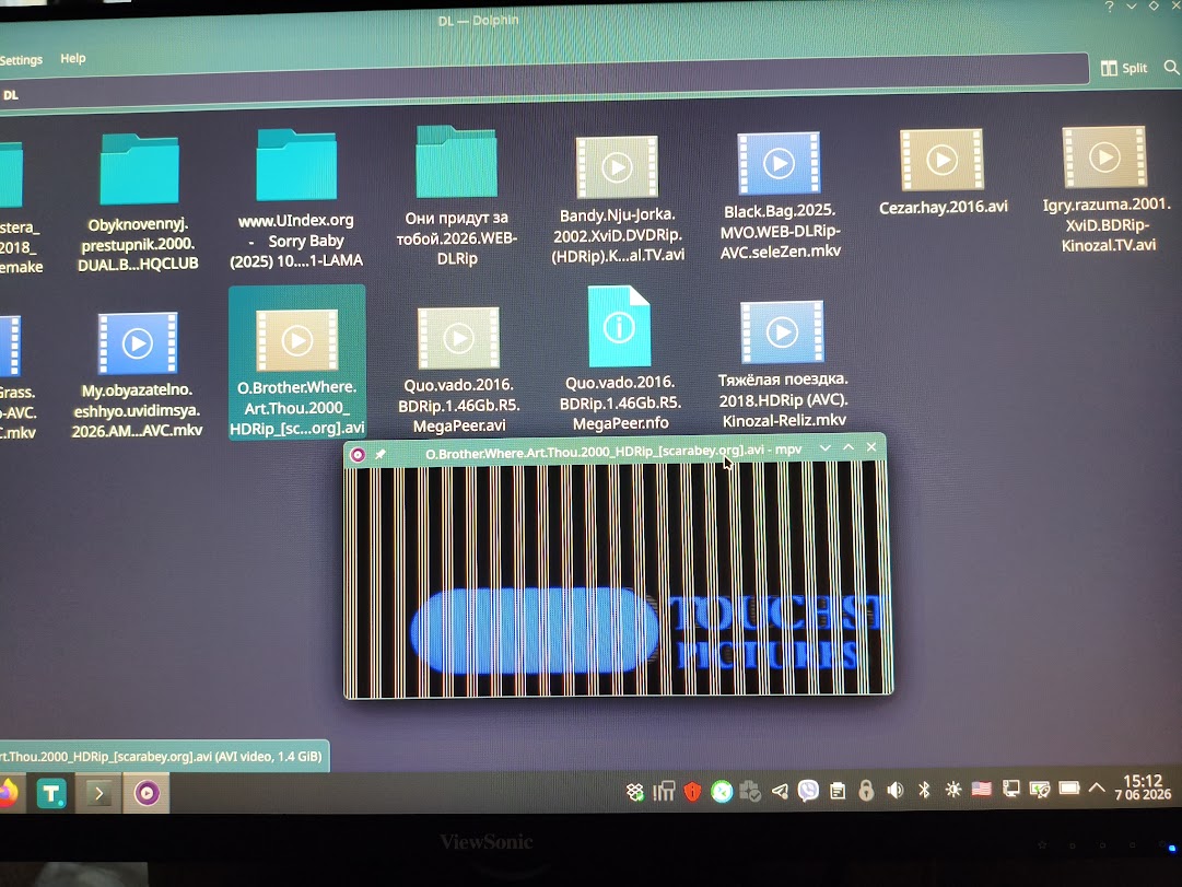

Suddenly when decided to watch a movie, got such picture:

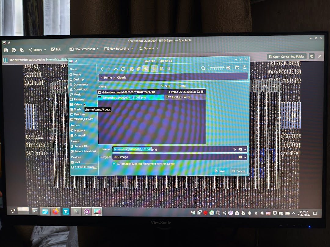

When i tried to make screenshot, it went even worse:
Of course first thought was “Good bye videocard”, but then i’ve asked Claude code and this is what I got:
T420 Mesa video corruption — resolved
** Root cause: Mesa 26.1.1 (installed 2026-05-28) introduced a regression in the crocus driver for your gen6 GPU (HD Graphics 3000 / Sandy**
** Bridge). It corrupted GPU-rendered surfaces — vertical bars / checkerboarding in mpv (vo=gpu), KWin compositing, and Spectacle — on both**
** LVDS-1 and the HDMI ViewSonic.**
** How it was diagnosed:**
** - LIBGL_ALWAYS_SOFTWARE=1 (llvmpipe) rendered clean → not the hardware/panel/cable.**
** - hwdec=no still corrupted → not VA-API decode.**
** - Conclusion: the fault was specifically the crocus GL path, not silicon.**
** Fix applied:**
** - Downgraded mesa + lib32-mesa to 1:26.0.6-1 (last known-good, ran fine May 3–28) from the pacman cache.**
** - Pinned them via IgnorePkg = mesa lib32-mesa in /etc/pacman.conf (line 29).**
** - Backup left at /etc/pacman.conf.bak.20260607-153227.**
** Bottom line: It’s a software regression, not failing hardware — the T420 is fine. The pin holds you on 26.0.6. Only remove the IgnorePkg**
** line to test a newer Mesa after the crocus/gen6 regression is fixed upstream, and re-test video + desktop before trusting it.**
After making this correction and reboot now everything is ok. So it seems to be some problem with Mesa 26.1.1.
