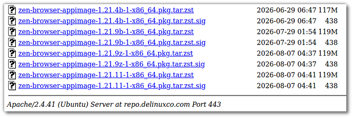

So as part of the the DeLinuxCo spin, I maintain AppImages in the DeLinuxCo repo, they are bundled in a package and delivered to the user like any other package. Everything works fine, no issues at all, except for Zen-Browser!
zen-browser-appimage was at version 1.21.9b, (this is the version method zen-browsers uses), a newer version is available, 1.21.11b. So I built the package with version 1.21.11b-1, but Arch apparently does not see 1.21.11b as newer than 1.21.9b, so it will never update. Apparently, according to Ai, the letter at the end causes this issue.
I am stuck, I want to move to a version number with no letters, but it will always see 1.21.9b as newer until version 1.22.0. Any suggestions on a way out of this circle?

From all i had researched is that, in order for pacman to see 1.21.11b as newer than 1.21.9b, it should have been tagged 1.21.09b.
So my main question, how to move away from using a string in a version number but at the same time forcing the update to the existing package installs?
I see no reason why I can’t just use 1.21.11, that way it just works as normal? I am thinking I would have to use “conflicts with”, but I can’t wrap my head around how I would go about it? I really don want to move away from the existing name.
I never had this issue because I started with version 1.21.4b

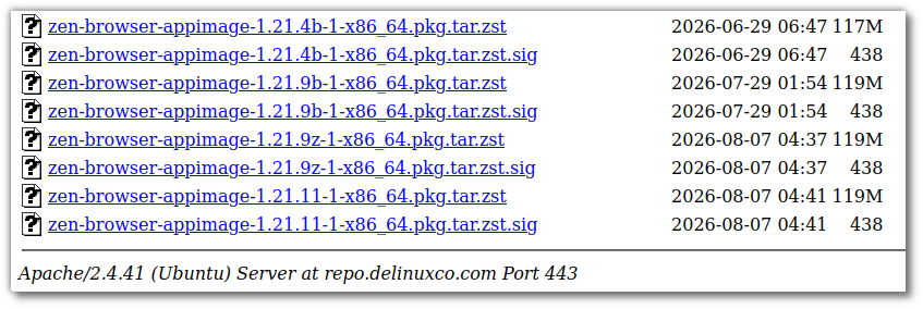

I even tried a version of 1.21.9z, thinking maybe it will roll over, but sadly it still does not see the newer package. Although it did upgrade to 1.21.9z perfectly.
João
@Teo was on the right track. I rebuilt the package to 1.21.09b, deleted the 1.21.9b and left the 1.21.11 there.
Renaming was not enough, had to actually rebuild the package that worked!
Systems are updating to 1.21.11 perfectly.
