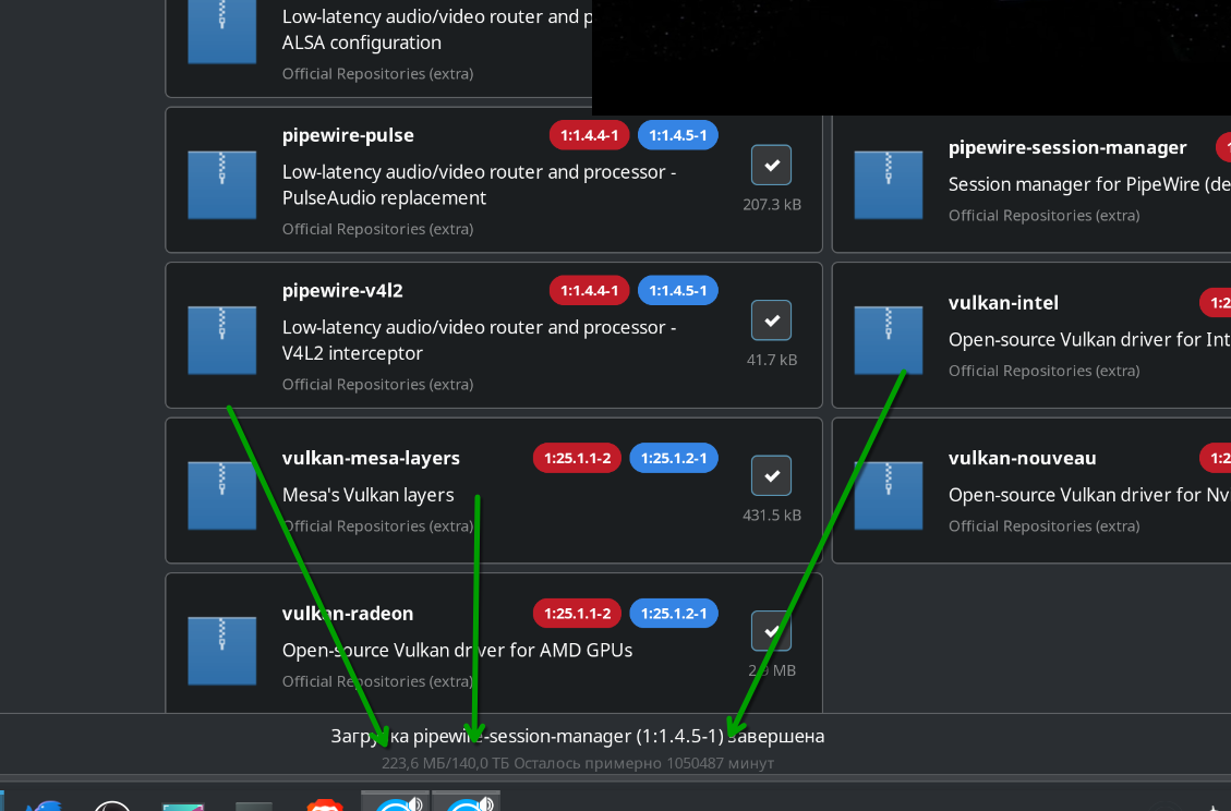

Hello everyone, after the last update, the package update is displayed in terabytes, although it downloads megabytes), it looks like this

I just rebuilt pacman on gpgme 2.0.0. Once you see pacman 7.0.0.r10.ga2d0293-3 available, the update will succeed.
There is something not quite right with pacman atm.
It showed weirdly high numbers for packages to upgrade overall and also for bytes to download overall. Both were ridiculusly high - it looked like some integer underflow to me.
I noticed this while upgrading with pacman 7.0.0.r10.ga2d0293-2, will keep an eye on it.
edit: captured output from another machine showing the problem:
 Total (             68/140710409285668)  85,6 TiB  4,90 TiB/s 00:17 [##############] 100%
I did not see this on my arch installs, might be manjaro specific?
I neither can reproduce the issue on Manjaro nor Arch.
However, someone else mentioned it here on the forums:
Started the day by checking up on this.
There is definitely something off with the calculation in the summary line :grin:
It is just cosmetic - I know - but the forum see comments on this like flies on a …
Total (64/140003036413984)   86,0 TiB  8,96 TiB/s 00:10 [---------] 100%
