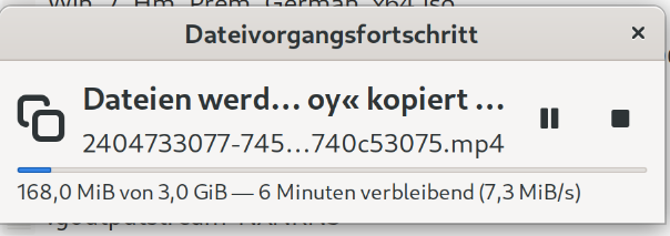

As you see i copied it with Thunar here:
Kingston DataTraveler 2.0 USB Stick with exfat formated. So a Ventoy Stick like yours but USB 2, not USB 3.
Well, then I don’t think that the speed drop is caused by the udev-usb-sync package, because the speed goes up to ~4MiB/s and drops again. That means, it fills the write cache fast and is bottlenecked by the usb device. It might simply be used up. So that is the actual speed of your device. Other than that makes no sense. Provide also the result on linux619 and/or below.

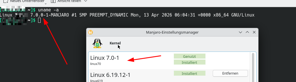

In any case, I resolved the sudden drop in speed by slightly increasing the write cache. The only drawback is that it now takes a few extra seconds to complete the write process after the progress bar has finished.
It is quite often that changes in the fundamentals - the kernel - requires applications or scripts to adjust.
I have played with the values and and I am almost certain this is a kernel issue and we will have to wait until the final release, which should be any time soon.

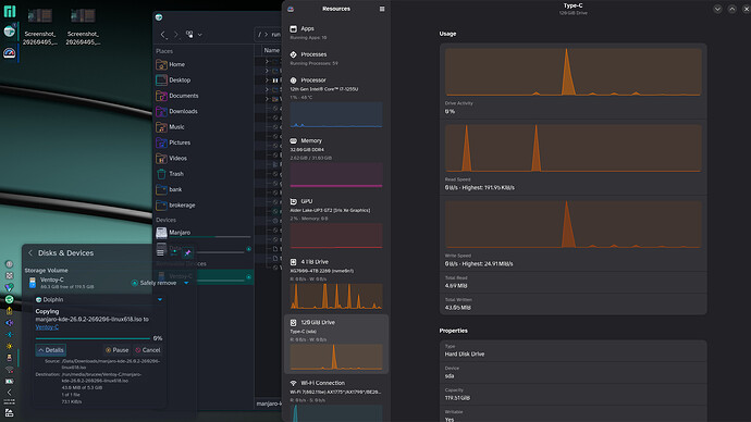

This is my WD MyPassport

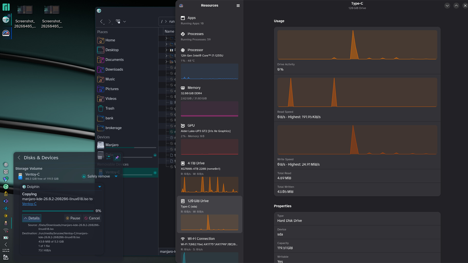

With modded values 0.1 and 1.6 it is impossible to copy an ISO to the disk.
The dolpin dialog displays an estimated copy time which elevates from 1m to days - up and down - until I cancel the copy.

Just to say on linux 18, I did not expect any thing to happen, but after a reboot the speed of copying went from 33 Mb/s to 74 Mb/s
Apologies for the delay in replying. Last night was the first decent night’s sleep I’ve had since an eye surgery ten days ago. Got in a solid 12 hours! Not for the squeamish: Vitrectomy - Wikipedia Had the “pars plana” variety.
Performed daily update on the unstable-branch laptop. Booted to 6.19 and performed test. It went so fast with the 131.5 MiB file I had been using, I couldn’t get Dolphin’s notification window open fast enough. Switched to a Manjaro ISO as the test file. Resulting screenshot:
Rebooted to 7.0, now RC7:
Note too that I’ve pinned open the notification from Disks & Devices to show current capacity of the flash drive.
While still under RC7:
dd if=/dev/urandom of="/run/media/brucew/Ventoy-C/testfile" bs=1M count=50 oflag=append,direct conv=notrunc                                      ✔
50+0 records in
50+0 records out
52428800 bytes (52 MB, 50 MiB) copied, 0.951596 s, 55.1 MB/s
I’m with @ManjaroDevOps thinking it’s a kernel thing. A change I noticed while writing this is that nomacs (image viewer) no longer launches. (It was fine under RC6 and before any other updates this AM.) Had to use gwenview instead. Have yet to look into that.
HTH! (And thank you for your work on this!)

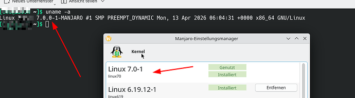

Upgrading to kernel 7.0 Message:
7.0.0rc7-1 IS NEWER than 7.0-1 :rofl:
Loading manually from mirror and installing, Message: downgrading 7.0.0rc7-1 TO 7.0-1
After rebooting the newer kernel 7.0.0-1 is the current one;
the RC does not exist in repos any longer.
What now? 7.0.1 or 7.0.0-1 ?
7.0.0rcX is newer than 7.0. A possible fix can be to change the version to 7.0.0, which is higher than 7.0.0rcX.
There seem to be a mismatch.
I’ve installed the one which is documented as “7.0.1” in via Manjaro Settings Manager, but after reboot the system is on 7.0.0.1
Maybe that somewhat confusing
That would be 7.0-1 and 7.0.0-1 notice the - is not a .
Evidence for me got get my glasses cleaned :face_with_monocle:
Thanks for it
