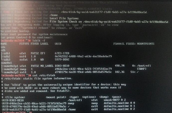

Unable to resume from device/ Dependency failed for /home
For some time during boot i’d get a message ‘unable to resume from device disk/by-uuid’ and today after turning on from sleep it entered emergency mode. I tried fsck -f -y on sda/sdb disks, i tried live booting but it got stuck on ‘reached graphical interface’. I dont remember which disk is /home on (home and root are on separate disks), i think sdb was an external hdd, i disconnected it before tring live usb.
Edit: trying Testdisc resulted in “Partition sector doesn’t have the endmark 0xAA55”, Photorec in '“P unknown”, ddrescue got 0 rescue with 3 retries and the following day the disk isn’t even showing in lsblk or partition manager/GSmartControl, so I’m going with hardware failure and ordering a new one.
If your /home is a partition on a second disk and that disk fail - you do have a problem.
I have no quick fix ideas for your situation.

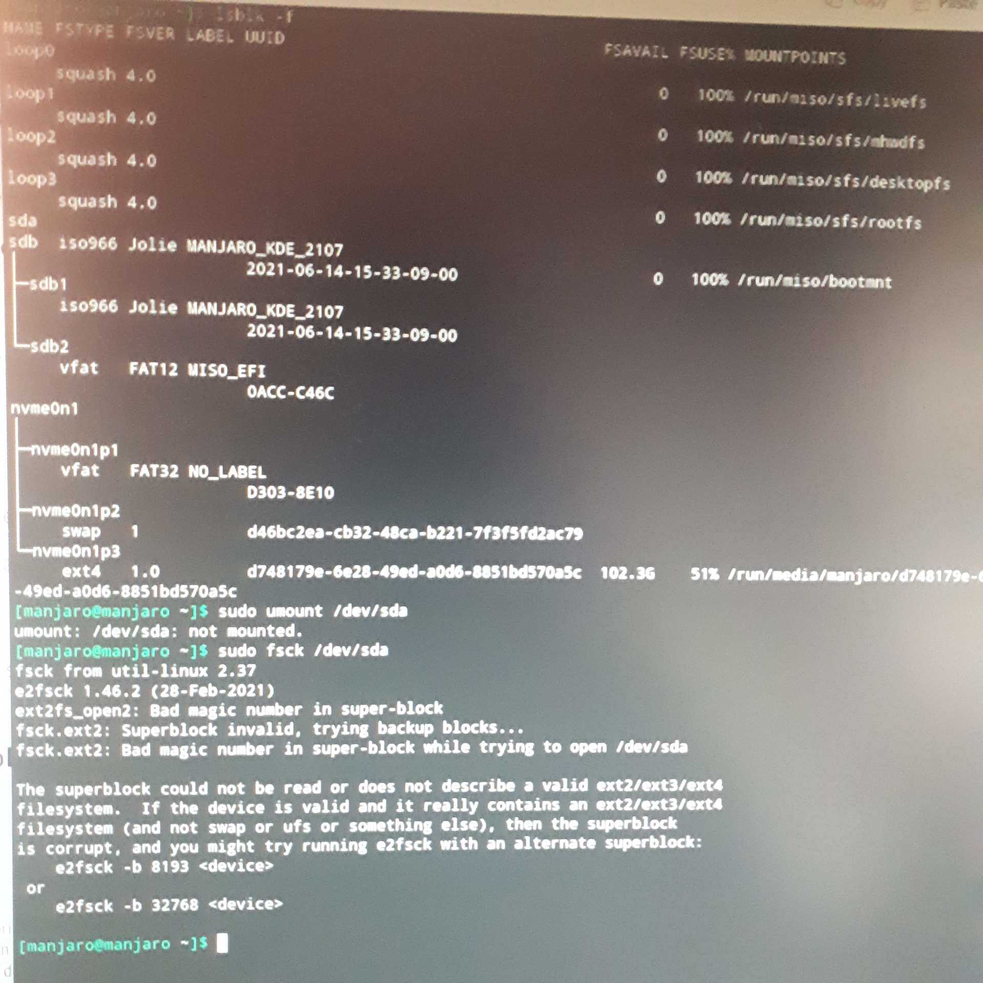

I didnt update, there were new updates, but i have to start them manually. I managed to get into live boot by switching monitor cable to integrated gtaphics but i cant log into this forum cause it says the browser is unsupported(dont know if i can install a new one?). I think home is on sda (sdb is usb), partition manager shows disk without partions, fsck says bad magic number in super-block. I had some power outages, i read that it also may be a cause?
Running the first suggested line says the same and running the second one gives a single line
E2fsck 1.46.2 (28-feb-2021)
This suggests that you are using an Old .ISO to boot from … best to get the latest one.

One thing is sure - you have filesystem damage on sda. I wonder if the root filesystem is also affected but i guess the more pressing issue is sda.
The info from the command is just an example. You will first have to list the backup superblocks on the drive to know the correct number in your case.
sudo mke2fs -n /dev/sda
Do not forget the small n, otherwise it will wipe everything !!!
It too just returned the line ‘mke2fs 1.46.2 (28-feb-2021)’

But those 3 “dependency failed” (or at least for /home because I wrote that and ‘timed out’ down to search about) messages were before trying fsck.
