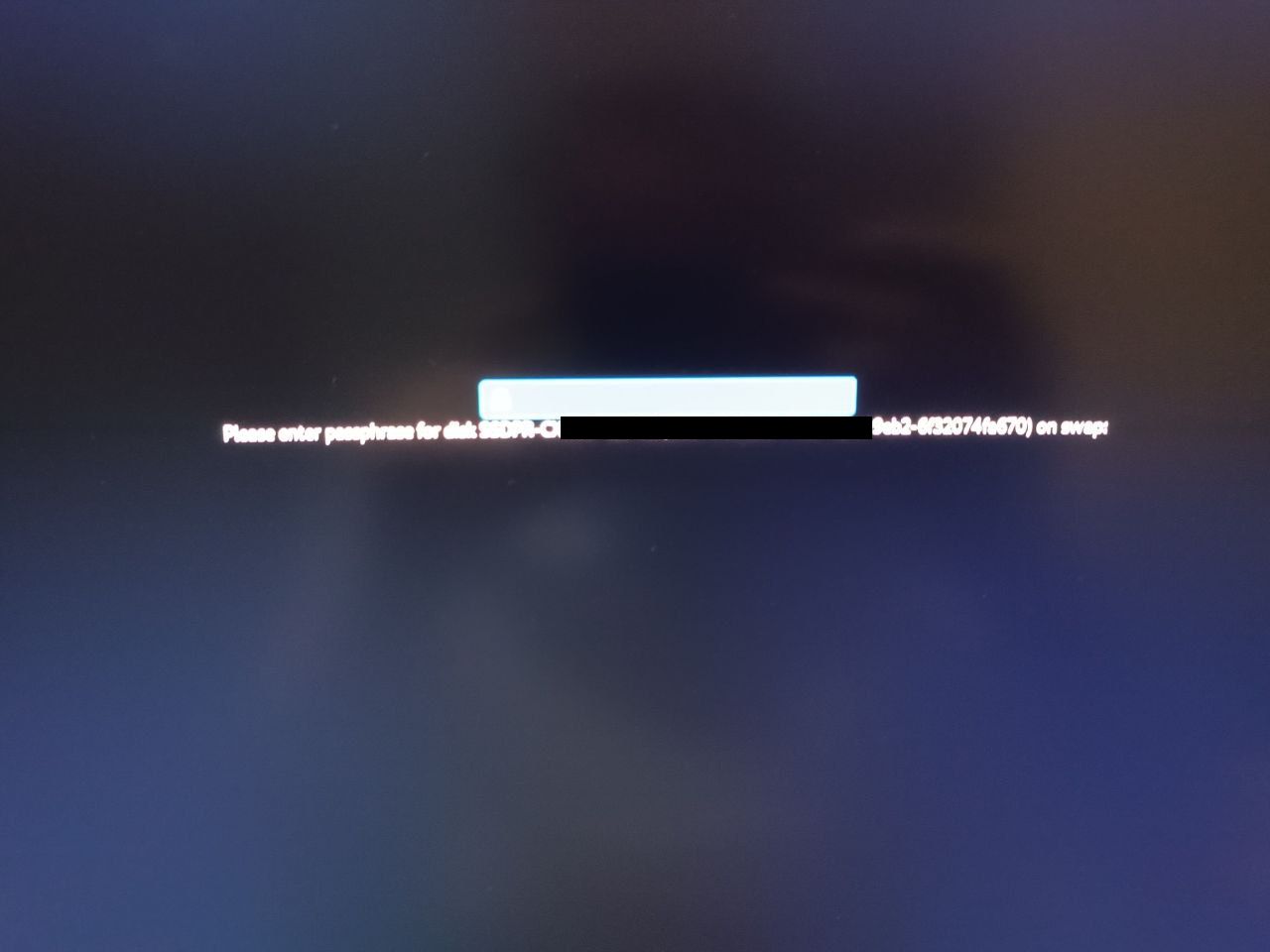

Unable to enter character «'» when entering password from luks (linuxswap)
I have a password set on linuxswap.
The password has the symbol «‘». If I press it on the keyboard, it is not displayed in the input field.
Only if I press first «’», and then any other symbol (once), then the symbol «‘» is displayed together with what I just entered. That is, at first it is not visible, and then two symbols are visible at once. At the moment, I first enter the symbol «’», then any other, delete this other and then enter the password.
Naturally, the symbols are hidden and only round symbols are displayed instead (hiding the password «•»). Is it possible to somehow fix this in the future?
This happened after the update on 05-03-2025
