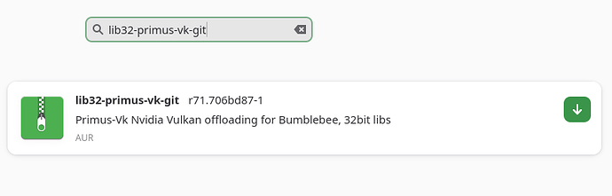

Trying to switch from opensource to nvidia drivers, bumblebee conflicts with prime
I can’t use blender until my open gl upgrades, so I figured to finally switch to the proprietary drivers should that be the path. Upon trying in the hardware configuration manager, i got this error message “Error: config ‘video-hybrid-intel-nvidia-390xx-bumblebee’ conflicts with config(s): video-hybrid-intel-nvidia-470xx-prime”
How should I proceed?

I took a chance, remove optimus, removed 4700, and installed 390XX. Now, my second monitor isn’t detected, and upon trying to reinstall optimus, this error :could not satisfy dependencies:
  • removing bumblebee breaks dependency ‘bumblebee’ required by lib32-primus
I only see one package by that name — lib32-primus-vk-git — and it’s from the AUR. Remove it.
it isn’t installed
The error message above says otherwise. :man_shrugging:
like in the above post, where optimus-manager-git was what prevented the removal
it is here/now a package called lib32-primus
uups - I intended to respond to @kiliman-jaro
not to you @Aragorn
But there is no such package in the repos. There is however a lib32-primus-vk-git in the AUR.
Do you have the multilib repo disabled? Because there is definitely a lib32-primus package in Manjaro’s repos:
