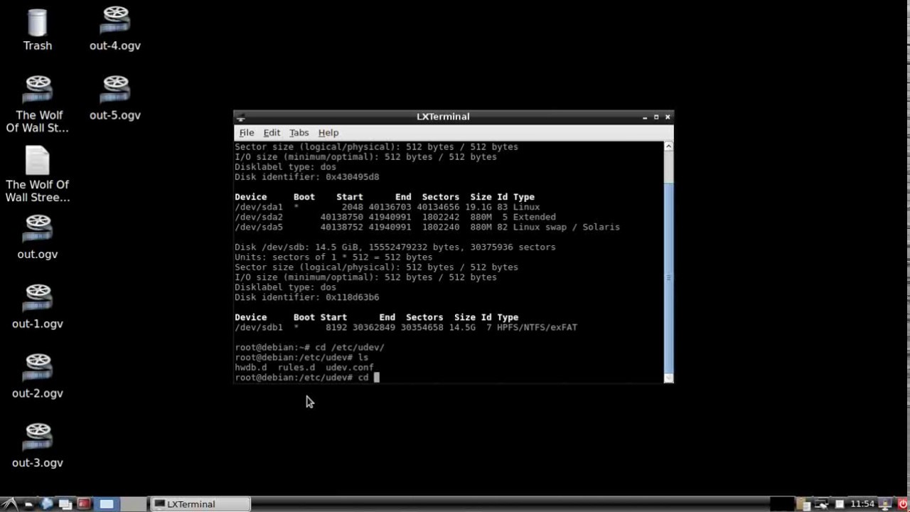

You know how to set this profile from command line?
if yes, maybe you can create a udev rule, to run this command when your USB device is plug in.
And what command do I need to execute to switch the mouse profile?
