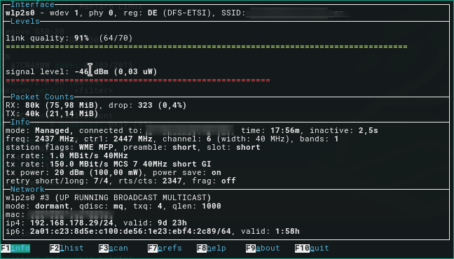

Didn’t know about wavemon. Thanks for showing it :smiley: Here something to compare:
Anyway, if you get a tx rate of 2 MBit then it runs on 802.11b or lower standard, while 150Mbit is 802.11n standard.
In your situation, I would check the router and play with the offered options. There must be something that makes it unable to negotiate the wifi standards. Since a similar problem was also with your old wifi card, I would assume that there is a problem with the router.
A little note: Why is no region enabled? I have reg: DE (Germany) enabled, as you see in the picture. :thinking:
