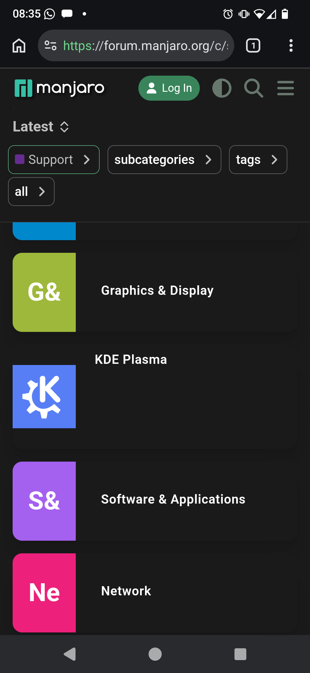

Hello,
While browsing the forum on my phone, I noticed that some subcategory titles are displayed out of place. It seems that it happens for the Horizon and the Graceful theme and only on mobile (Firefox) but not the desktop variant of the website.
As far as I can tell that is true and for some subcategories in Support (Xfce, KDE, Gnome), Other languages and ARM. (See screenshot)

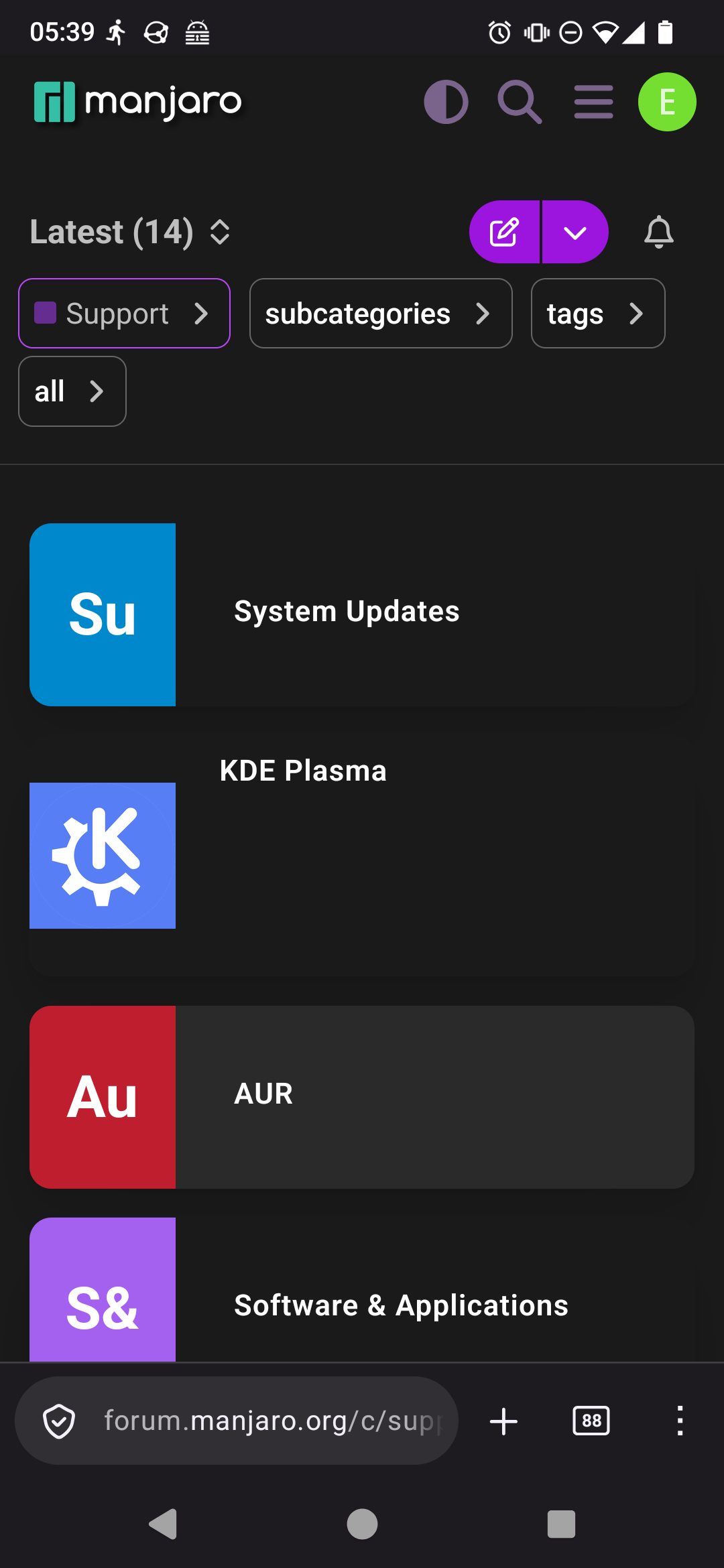

In addition I tested the browser shipped with the Android, which is a fork of Chromite. I never use it, so it should give me the standard look for a guest. There it is displayed wrong too:
The same on a Google Chrome installed fresh just for the purpose of testing: some categories are displayed out of place

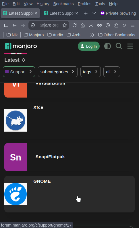

Misalignment affects Support subcategories KDE Plasma, Xfce and GNOME
Also ARM subcategories Plasma mobile, Phosh and Lomiri

It seems that the subcategories that have a logo are displayed wrong. That is so far the only difference between correctly displayed and wrongly displayed items I can find..

I spotted a pattern - and when I looked at the configuration for the sub categories - found that the affected categories had an image attached.
The images used were a mix of .svg and .png and sizes too.
This may have worked before, but now they skewed the card layout - I know very little of css so I removed the images and now the cards align identically.
So you are right - the three categories was skewed - now they are not.

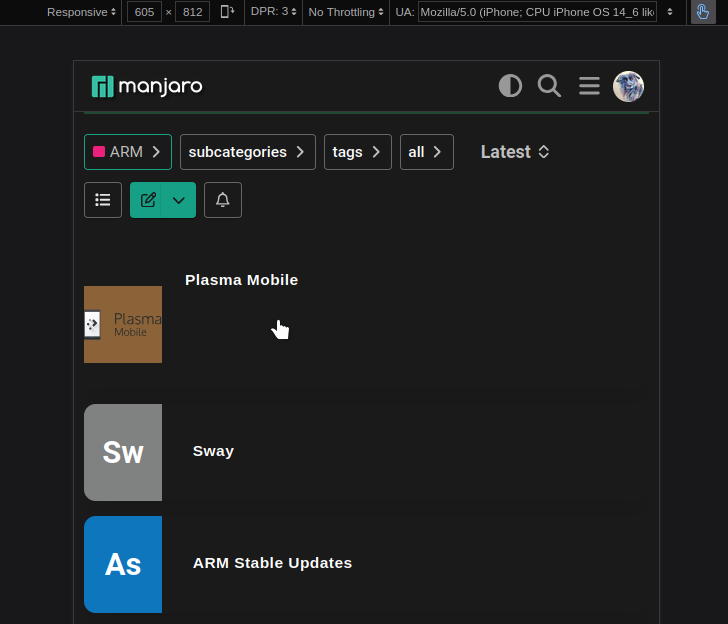

I also just did some troubleshooting using the web developer tools of Firefox for desktop.
It seems that it also depends on the screen size.
After turning responsive mode on one can change the size of the web page. Below a certain width it switches to the wrong display
And with my limited .css knowledge it seems that the following rule in mobile.scss is the culprit:
.category-logo:not(.no-logo-present) + .category-details {
max-height: 132px;
height: calc(132px - 1em);
padding: 0.5em !important;
Specifically the height seems to be the issue…

Firefox Responsive Design Mode shows misalignment if window width < 640px
No misalignment when switching viewport to landscape mode,
