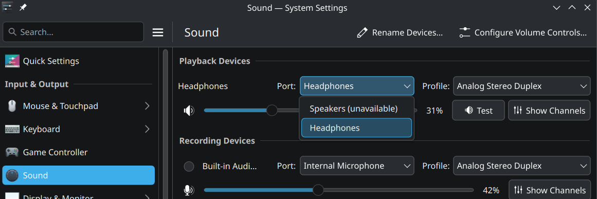

  • In System Settings → Sound if I go to the ‘Port:’ dropdown on ‘Speakers’ I see ‘Speakers (unavailable)’ for the onboard speakers and cannot get audio out of them at all. If I change to the ‘Headphones’ port and turn up the ‘Line Out’ in AlsaMixer I do get sound normally out of the desk speakers via the headphone port.
  • When I change back to the ‘Headphones’ port in Sound Settings the Line Out in AlsaMixer returns to 0% and I get very quiet audio again. It can be turned up again but it doesn’t hold. With AlsaMixer open I can see this happen in realtime as soon as I change back to ‘Headphones’. I did run sudo alsactl store after fixing the Line Out and this does not make a difference. Note that switching to Bluetooth Headphones (ie. a separate source rather than a separate port on the same source) does not cause this issue.

Not sure if this makes any difference; I just discovered the volume setting in alsamixer also resets on sleep/wake, not just on full reboot.

Data from amixer shows Speaker output is muted [off]
Simple mixer control 'Speaker',0
  Capabilities: pswitch
  Mono:
  Front Left: Playback [off]
  Front Right: Playback [off]
To unmute output:
amixer --card=PHC sset 'Speaker' unmute
Data from amixer shows Master volume control for playback is set to -29.25dB (55%)
Simple mixer control 'Master',0
  Capabilities: pvolume pvolume-joined pswitch pswitch-joined
  Playback channels: Mono
  Limits: Playback 0 - 87
  Mono: Playback 48 [55%] [-29.25dB] [on]
Increasing volume in alsamixer to about -10dB to -6dB should provide sufficient volume for external speakers with plenty of headroom to avoid distortion.
When all alsamixer settings are optimal for you, use sudo alsactl store to save settings, and check if the new settings are restored after sleep and reboot
sudo alsactl restore does seem to restore the settings I have saved, but it is still the case that when I boot, wake from sleep, or switch from speakers to headphones the Line Out resets to 0 and I have to manually set it via alsamixer or via this restore function.
This does not work. Running the command does change what amixer outputs:
  Mono:
  Front Left: Playback [on]
  Front Right: Playback [on]
However I still do not get any sound from the onboard speakers and it still shows (unavailable) in Sound Settings.
If I do select the speakers here I still get no sound and it also resets the Line Out volume to 0. Unmuting via amixer did not change this behavior.
This doesn’t seem related, at 60% per the GUI amixer shows it as -12.75dB and even that is approaching “too loud.” The master volume controls behave as expected, but only for the desk speakers and only by changing Line Out from 0 to 100 after every reboot and wake.
If I keep the Line Out at 0 but turn the Master up to 100% (0.00dB) and crank the physical volume on my speakers it’s still barely audible. Setting the Line Out to 100 causes the master volume to behave as I expect/am used to from prior to the update, but again the issue there is it keeps reverting to 0 even if I save the settings.
None of the above has changed the behavior of the onboard speakers, which still show ‘unavailable’ and produce no sound.
PipeWire port analog-output-headphones can be either available if the jack is plugged in or not available when unplugged, but the analog-output-speaker port cannot be disconnected and should be availability unknown (similar to the analog-input-internal-mic port)
The Speaker port could be unavailable in PipeWire if Auto-Mute Mode is enabled AND headphones (or external speakers) are plugged in (but amixer data shows Auto-Mute is Disabled)
The Speaker port cannot be unavailable due to Speaker output being muted, so it could be that Wireplumber user settings have become corrupted. changes in sound devices might have led to Wireplumber creating multiple configurations to accommodate changes
To reset WirePlumber:
  1. Stop the user service for WirePlumber:
systemctl --user stop wireplumber.service
  1. Delete ~/.local/state/wireplumber/ folder and contents
rm -r ~/.local/state/wireplumber/
  1. Restart the user service to create a new folder
systemctl --user restart wireplumber.service
ArchWiki - WirePlumber - Tips and Tricks - Delete corrupt settings
