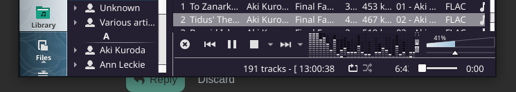

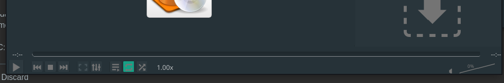

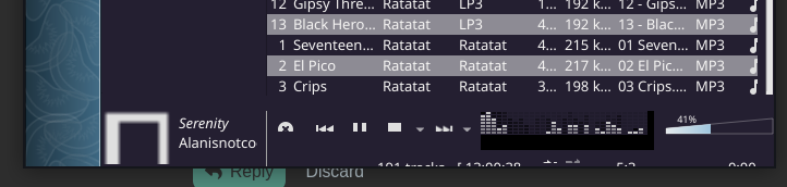

Since this update, some applications have some areas cut off. The taller the window, the more pronounced the issue gets.
VLC
Both images have this forum page in the background to show that it’s not just the screenshot cut off. Also, the bottom position of the window border is the same, I just dragged the top border up for the second window.
Another app that experiences this is Clementine:
