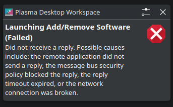

No problem except I noticed that the Add/Remove Software dialog quit and after the install i wasn’t prompted to reboot. I rebooted nonetheless and everything seems to be working, except I still can’t open Add/Remove Software dialog. It crashes everytime i do.

Not sure why, but eventually dialog was able to launch. So nevermind.
I seem to be getting the same as @luzpaz trying to open Add/Remove Software I get this error popup but it does open after several minutes.
Same thing with me,
** Message: 23:30:30.691: flatpak_plugin.vala:393: refreshing flathub appstream data
Did not receive a reply. Possible causes include: the remote application did not send a reply, the message bus security policy blocked the reply, the reply timeout expired, or the network connection was broken.

Ok, looks like it’s the Flatpak support that’s causing the hang. Running pamac-manager shows this:
** Message: 20:47:12.918: flatpak_plugin.vala:393: refreshing flathub appstream data
** (process:9744): WARNING **: 20:50:13.221: flatpak_plugin.vala:398: While pulling appstream2/x86_64 from remote flathub: While fetching https://dl.flathub.org/repo/delta-indexes/yX/AaiYWjQiqWfaUrH+RZuyqrw5t+BEVyUYehqT2G6R0.index: [28] Timeout was reached
And if I disable Flatpak support in the preferences once it opened fixed the slow opening.
How can I disable it if it doesn’t start? I updated the system, rebooted, and it still doesn’t start
It freezes if I run this in the terminal.
pamac-manager                                                                                                          î‚Č ✔
** Message: 23:54:03.862: flatpak_plugin.vala:393: refreshing flathub appstream data
** (process:2818): WARNING **: 23:57:05.436: flatpak_plugin.vala:398: While pulling appstream2/x86_64 from remote flathub: While fetching https://dl.flathub.org/repo/delta-indexes/yX/AaiYWjQiqWfaUrH+RZuyqrw5t+BEVyUYehqT2G6R0.index: [28] Timeout was reached
Poor guy pamac seems even more buggy. Didn’t want to start, didn’t want to refresh databases from the first time, trying to install new optional dependencies for yt-dlp failed without any understandable message
 at least for starting the solution is to disable the flatpak support. One can also do it from the /etc/pamac.conf file, just put # at the end before EnableFlatpak
